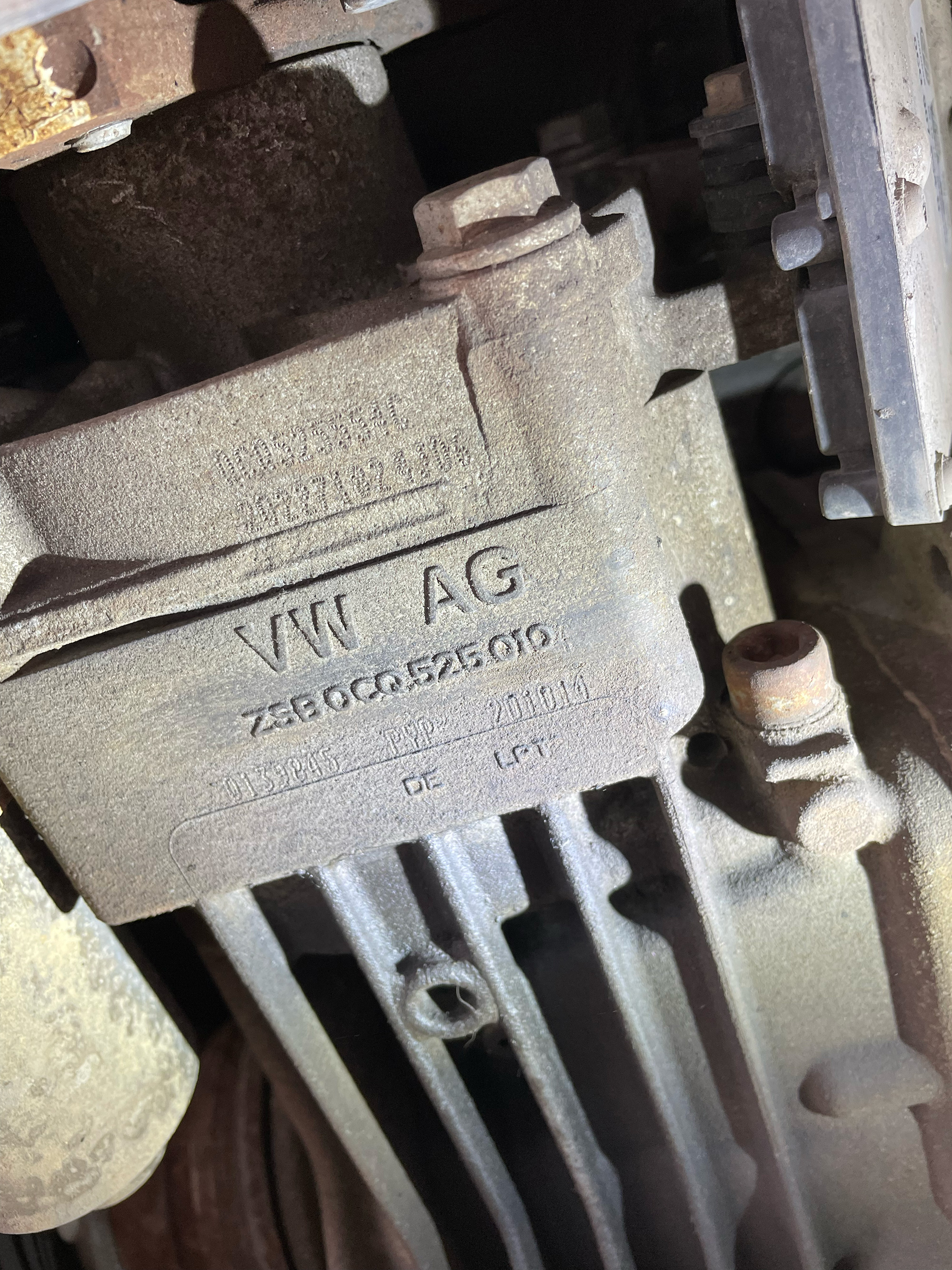

  22. Wow – 'shop grafting gents! I've just watched the Aussie and Dutch Rear Diff removal (and servicing) videos. Well beyond my pay-grade! Question, I've been told I need 0BR525010Q rear diff, but lllparts.co.uk says the Q model replaced by L and S variants. Is there any way of finding out which 'part number' models will fit my Skoda please? Prices are such that I might have to 'send the diff away' to be rebuilt (and lose a (summer) month of car use!). Thanks.

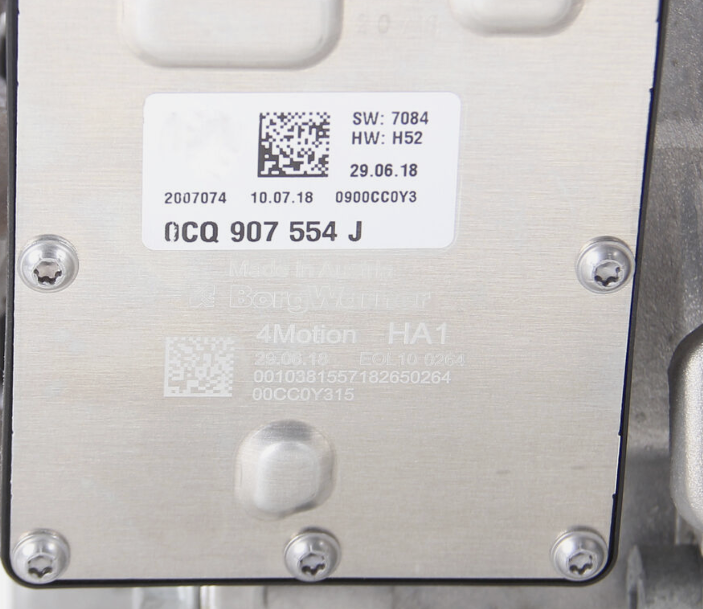

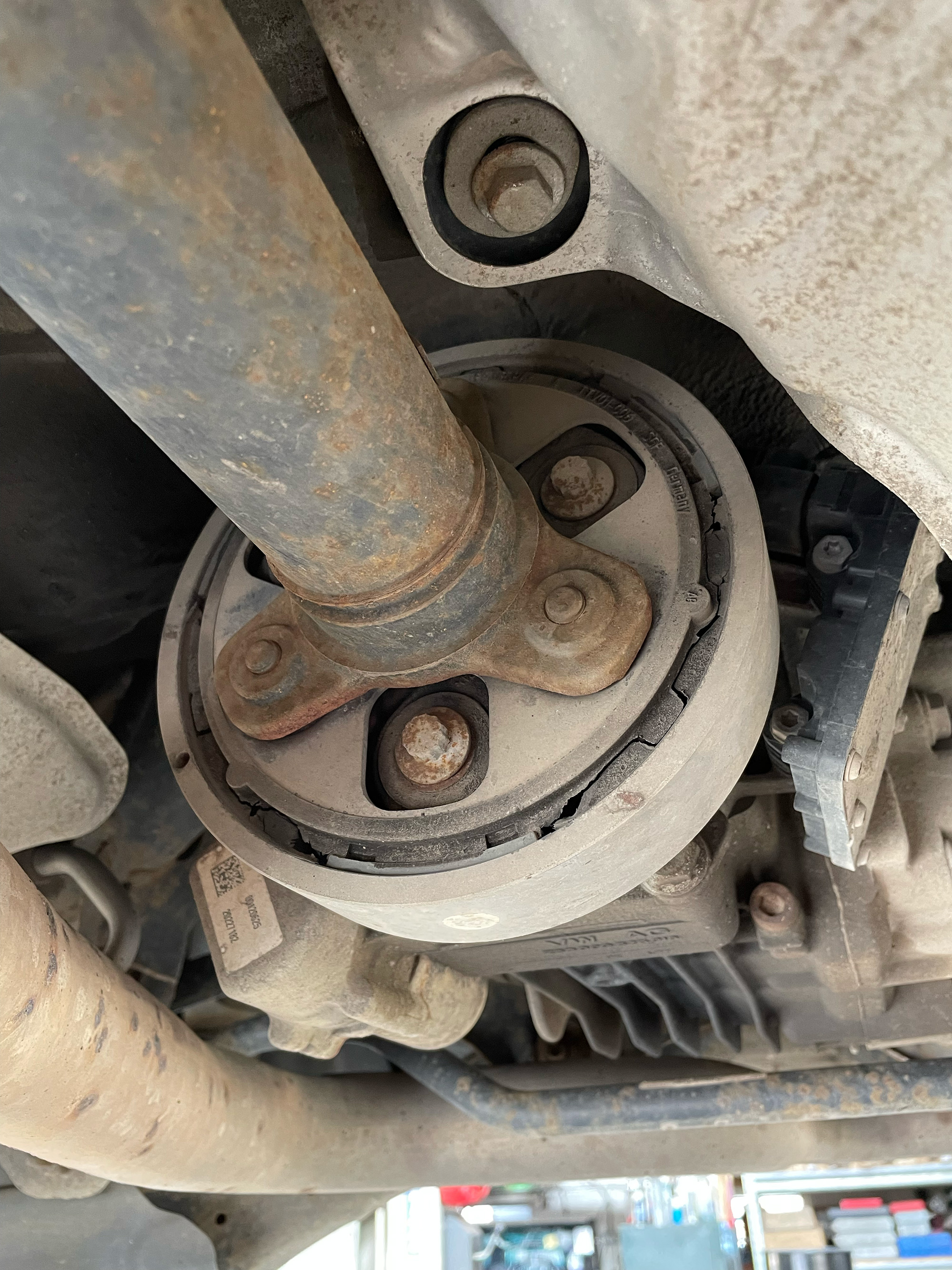

  24. Found the rear diff just searching eBay – they have been efficient in requesting VIN and confirming the correct part. I've no idea if it's local manufacture or not – the pictures clearly show 'made in Austria' on the unit but they also say "To avoid customs problems, we might have to remove the logo on parts." …it's tricky to know who is who and what is what these days. Guess I take a punt – benefit of the doubt. As for the coupler – garage man shunted it this way and that and told me it needed replacing – trust him and makes sense to get it sorted when the back of the car is being dismantled/repaired. Thank you for you thoughts.
  25. Extra update from me. Couple of pics. I'm likely going to buy a 'new' unit from China/eBay – anyone else done that? Appreciate breakers unit is an option but difference in price makes me think a new unit better than a XX,000 miles one. And I want the car back on the road asap – save time if new one replaces old unit in one 'garage session' rather than 'send away for refurb'. Opinions welcome (particularly of people getting OEM stuff from faraway). And, best place to get the 'coupling' (see picture) that needs replacing too. Thanks.
