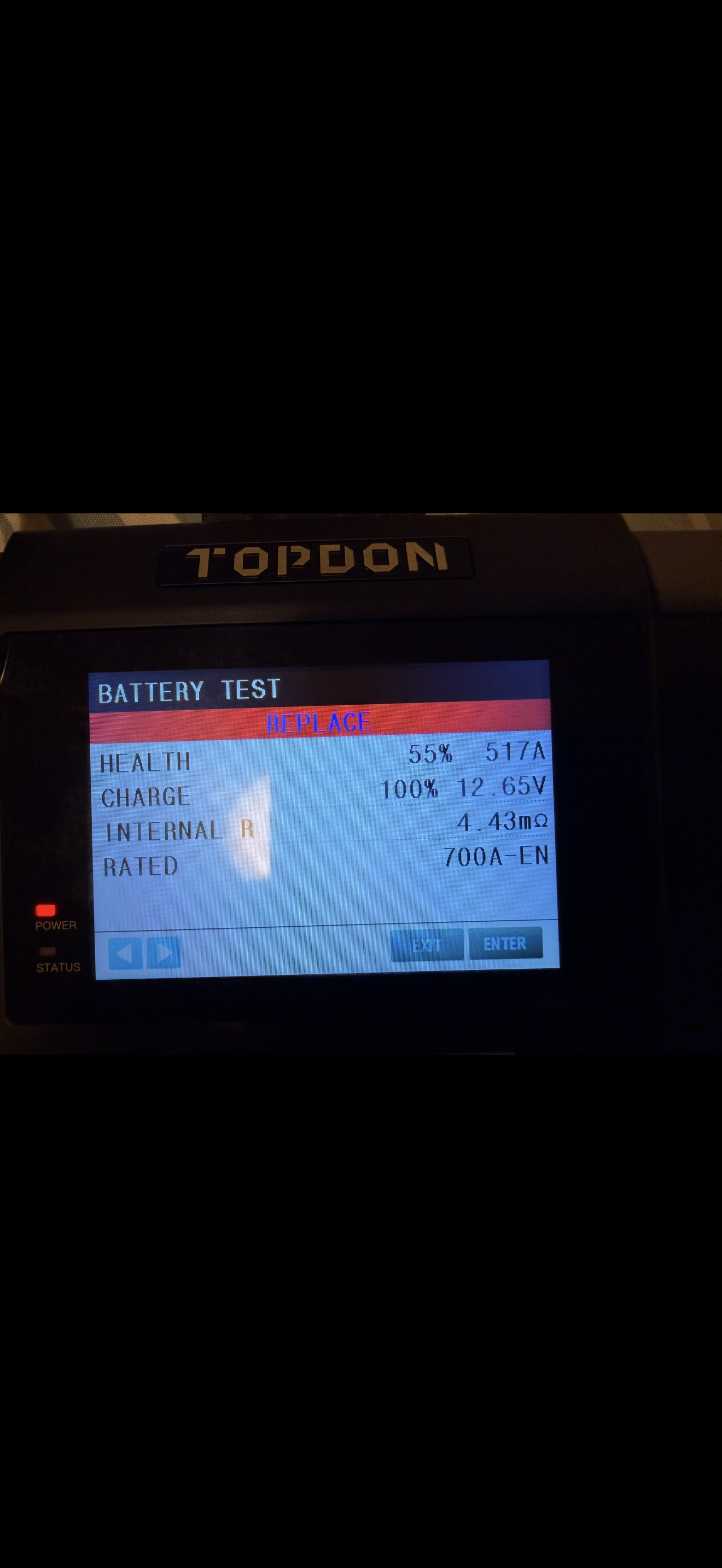

Dodgy OEM Battery?
Yep will give her a good charging one of the days. The average of 12.6v resting is quite accurate. The battery monitor is directly on the battery via Bluetooth on my phone, all locked up overnight so everything shutdown. It matches my multimeter reading and the reading on the obd11. It gets it’s reading from the battery sensor. I do feel the battery is charged to it’s optimal that the car will allow as I don’t do many short trips while doing 1k a week. I never use the heated seats etc One thing i have noticed with obd11 is the brake regeneration mode doesn’t kick in unless the state of charge is 70% plus. I also noticed brake regeneration is turned off when outside temps drop below 6-7 degrees C. Yes it’s a diesel DSG. interestingly the consensus on the net is that EFB batteries aren’t recommended for brake regeneration. They sre supposedly designed for start stop only.
Dodgy OEM Battery?
Some more observations in my case. According to obd11 ( if accurate) my battery state of charge hovers on average 70%-73% . I rarely ever see it at 80%. Yesterday i was hoovering out the car so the doors would have been open for 15-20 ish minutes. The interior led lights were on i’m sure. State of charge dropped to 59% which i thought was a big drop. I turned the Ignition on and voltage was about 11.8v. The car started ok. The OBD 11 minimum start voltage after i hoovered the car was 7.35v but the engine was cold so i’m sure the heater plugs were on also so I’d expect that voltage however it generated a fault code in the brake booster system low voltage. I did a cranking test with my battery tester a few weeks ago and the lowest i got was 7.95v For comparison i tested the battery when the car was new. It read 800 amps. The battery is 700 amps. Today it reads between 480-540 amps depending on it’s mood. It reports “ replace” I put a battery monitor on the battery and in the morning it reads an average of 12.6v ( sometimes 12.55-12.63v)
Dodgy OEM Battery?
My 2 year old Octavia vRS came with a Varta EFB. It’s not very fresh after only 2 years. My battery tester fails it and i often get low voltage codes on the OBD 11. The car starts fine though and the start stop works ok. The car does 1000km a week and rarely has short trips. They should be fitted with AGM batteries. The AGM in my last car, a Passat lasted 7 years.

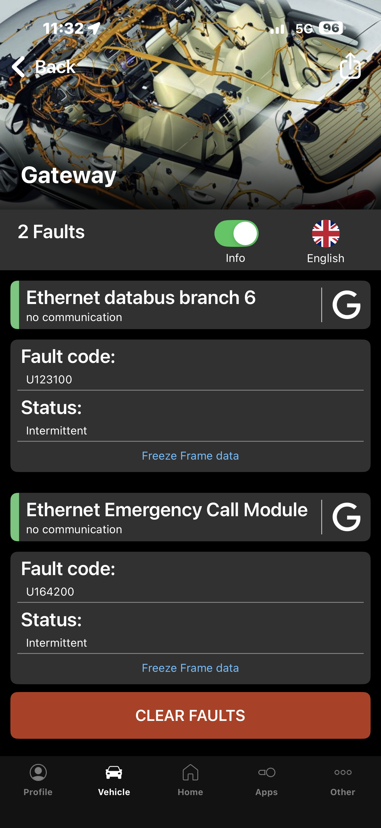

Function temporarily restricted due to battery budget (B1915F1 error code)
Interestingly these two new codes appeared today never had them before. However there were no malfunctions. Everything working fine.
Since i bought the car new i have had that code come up every so often. I haven’t had it for a while until this week. It’s the first time it’s come up twice in the one week. Maybe it’s part of our typical octavia glitches.
Yep. It came up Tuesday. I cleared it. All ok yesterday and came back today. Cleared it again and so far hasn’t returned .
The car had a lot of driving this week including a round trip to the UK from Ireland. Voltage reads good anything between 12.6-7v.
Anyone come across that error code? It has happened to my car twice this week. When the fault occurs it annoyingly affects the infotainment system. It takes ages to boot up “ loading settings “ when you get into the car. Also you can’t access the car via the Sloda app when the code is active. I read somewhere it might be the SOS back up battery going faulty ? Anyone else have this problem?
