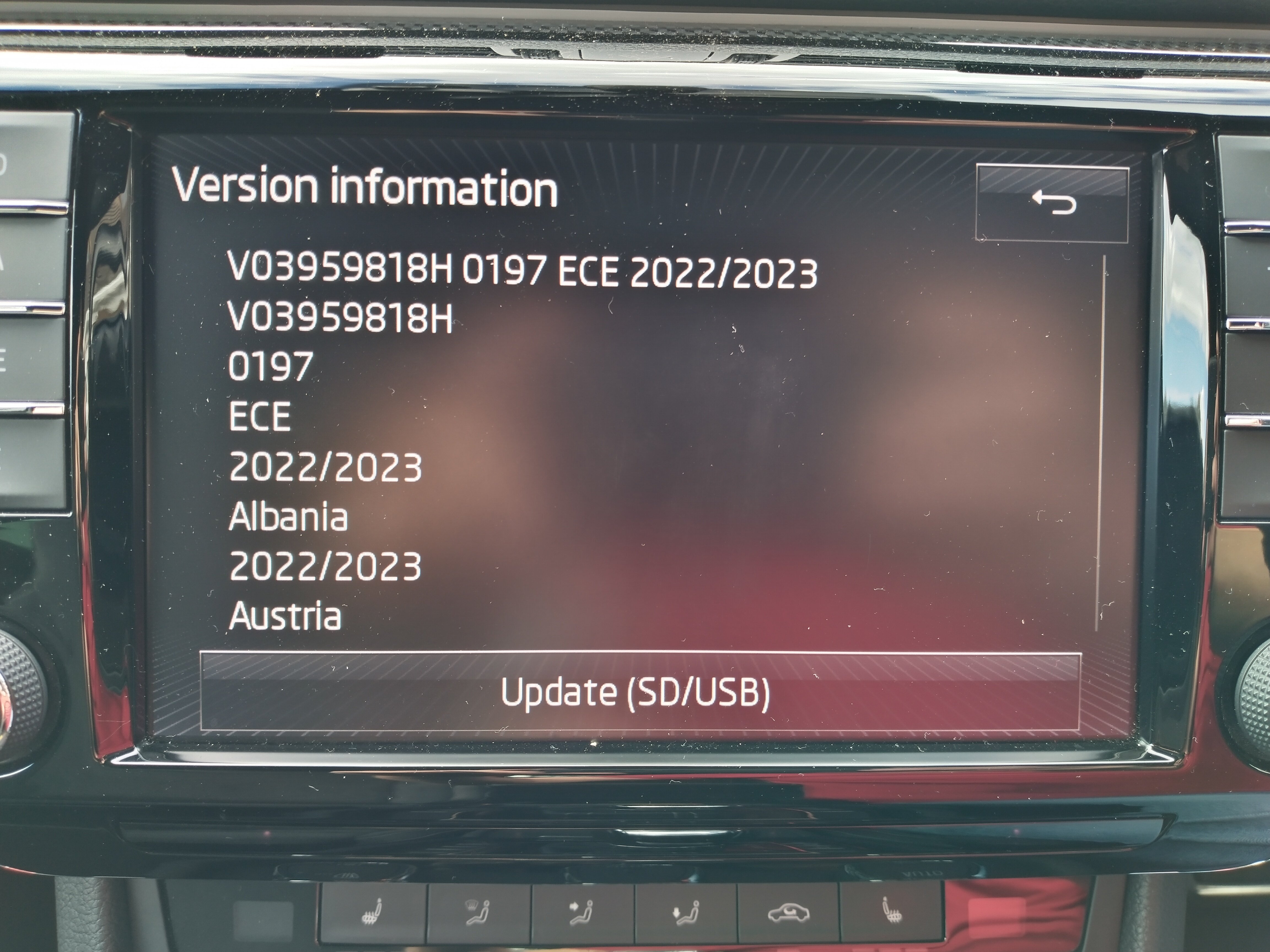

  • Oh yes.. what it looks like on a Seat 😂 It swaps in the Seat part number 🙂

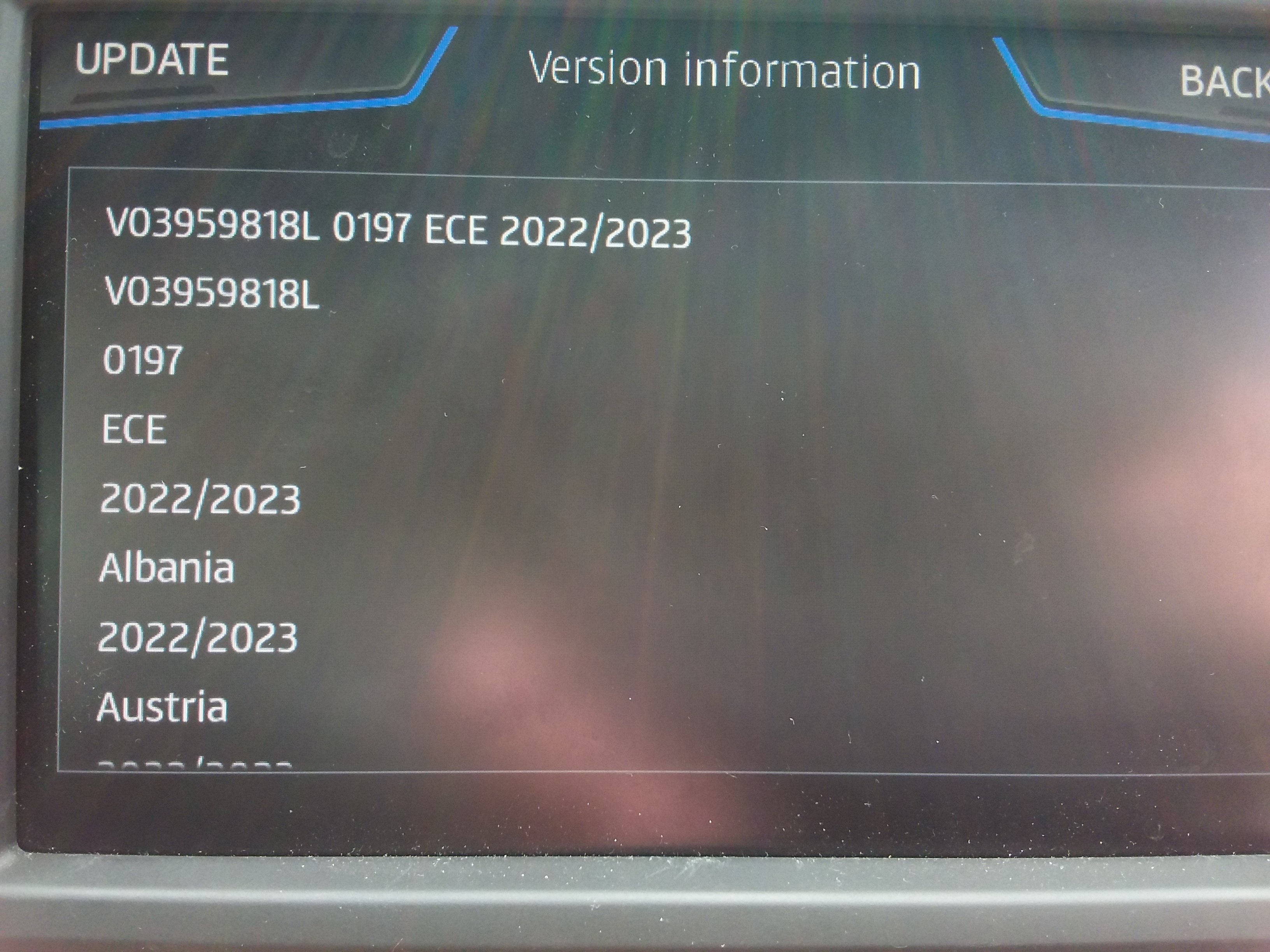

part numbers and version info are stored in the \Mib2\NavDB\DBInfo\0\default\DBInfo.txt
Quote
PartNumber1="V03959802TP"
PartNumber2="V03959809PB"
PartNumber3="V03959818H "
PartNumber4="V03959818L "
PartNumber7="V03959804ET"
PartNumber5="V03959804QH"
ApplicationSoftwareVersionNumber="0197"
SystemName="ECE 2022/2023"
Variant="ECE"
ReleaseName="2022/2023"
DevVersion="P197_N60S5MIBH3_EU_NT_Q3.21"
just guessing:
1. - ? ? Audi ? ? VW
2. - ? ? Audi ? ? VW
3. - Škoda
4. - Seat
7. - ? ? MAN ? ? Lamborghini ? ? Porsche ? ? Bentley
5. - ? ? MAN ? ? Lamborghini ? ? Porsche ? ? Bentley
Edited by MartiniB

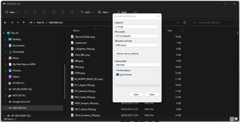

can you try format fat32
I always use a 32gb SD card in Fat32, £7-50, class 10.

I used the same card as I used previously and noticed it’s in NTFS format, fat32 not on windows 11 anymore (can’t remember if it was in w10), hopefully it’ll work again

Fat32 is on my Windows 11 and it's up to date. You can't format above 32gb in Fat32 hence where exFat comes in.
There are some utilities that will do the business if you really want Fat32 on a big drive.
https://www.sdcard.org/downloads/formatter/
However since 32GB is the current recommended size and you have that card then Fat32 is fine. If you use the more fancy formats on the 32GB card the file allocation method takes up space and you won't get the image onto it. Germanic boards were rattling on about this last time round.
Anything other than Fat32 isn't suppose to be used since you are suppose to stick with a 32GB SD card. Off pista if you move away from that.

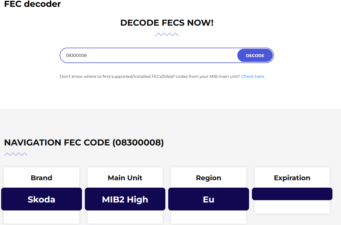

08300008
That's the magic FeC I have for Skoda and the ones that the M.I.B. people use.... yours is a Audi one, whilst Seat work with Skoda not sure the other way round with a Skoda one and that was via the developers back end thingey Skoda works in a Seat. You need to get it at 08300008.
In June 2021 VAG left the Seat FeC out of the release so it couldn't be read in. May be something similar with Audi in this release ?.
Their lookup
http://mib-helper.com/fec-decoder/?fec=08300008
Edited by Tell
more FeC stuff
BooBoo the other thing to do is try uploading an old Map which you know the unit took to test whether the Audi FeC can be used with this release. I think we are getting somewhere... if it is the Audi FeC then the Skoda 08300008  may work. Never got down to the bottom of why VAG left out Seat this time last year, then put it back on the six month in November.

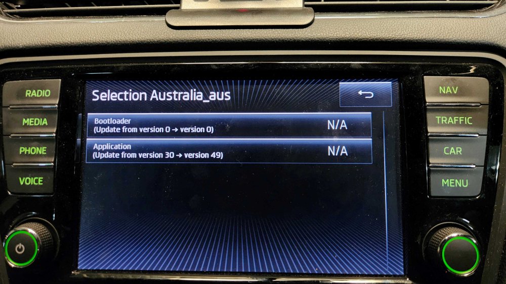

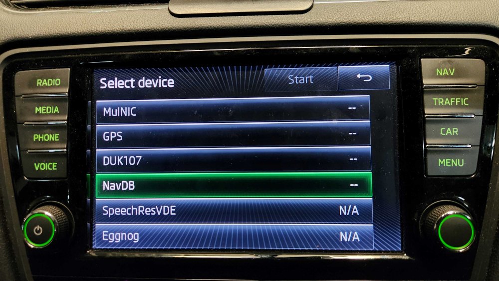

I did a Google... why I said if all the rest is correct then may be VAG have taken the FeC out for Audi, way to test on an old release of the maps. With Seat in the developers SWDL menu where the navigation FeC is unsupported  you see N against the map attributes. Y is good (will be the same). You can have a look in there. If you aren't seeing the media, then it's not seeing the media, but if it is seeing the media if will show the media to select. Tap it.
You go SWDL, manual download (tap), then start (below tap), then you can scroll down the attributes. NavDB, Eggnog etc. N is bad, Y is good. Doing an update that way you have to open and close the door every 15 minutes to keep the unit live. Dont start the update if the attributes arent marked as Y.
Edited by Tell
(Or a slight variation on the second para on when you see the attributes before Start or after, second bar down. The main thing is it differentiates out between when the media is being seen and whether what is on it is correct, wobbly navigation FeCs get identified on NavDB not being possible, see the rest and it's seeing the media, just navigation FeCs won't allow the update)
As expected from previous results it worked perfectly with NTFS 64GB :)
It does... but won't on a 32gb card unless it's in Fat32 due to the overheads of NTFS addressing against Fat32. The addressing takes up the space so the image won't fit on. It popped that one about a year ago. People love NTFS so format willy nilly in that... if you do that on the standard navigation map card the unit doesn't read the card correctly as well as a fair few people screwing up their navigation cards since newer ones don't take too kindly to being reformatted.
Keep it simple stupid approach applies else you end up digging people out of a mess they put themselves. That's buy a 32gb SD card class 10 for the purpose, keep to fat32. That might change if the high maps outgrow 32gb and the unit can support that. Not sure on the latter. Must be an unpublished upper limit in the QNX code.

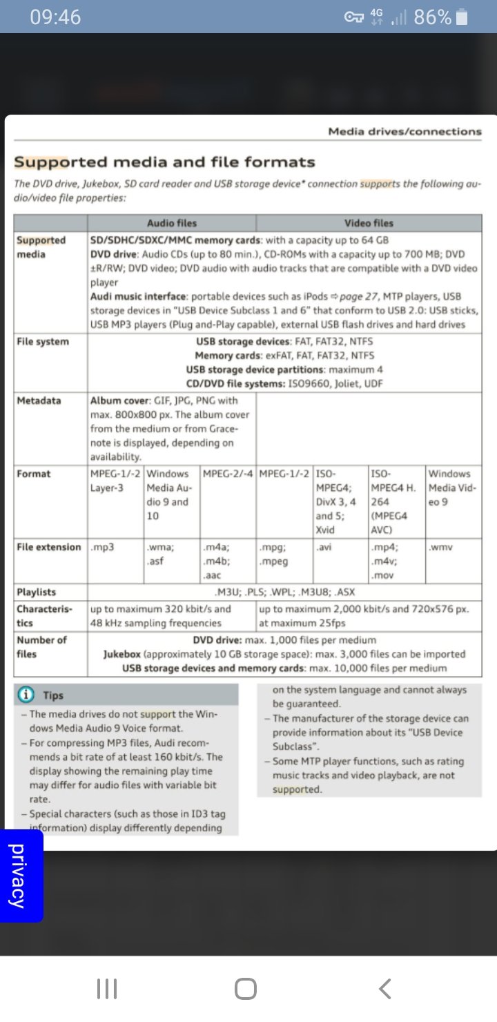

After looking at the manual the MMI will only read exfat via SD card & not USB. So above 32gb NTFS is indeed the go to format
The VW PDF attached on updating the mib2 high where it's says 32gb, fat32 SD card, class 10. Basically deviate at your peril. I know some of the Briskoda people like to take the top road 😂. For £7-50 saves a lot of trouble although with newer laptops you might have to buy a USB / SD adaptor which don't have an SD slot... another £7-50 or so.
