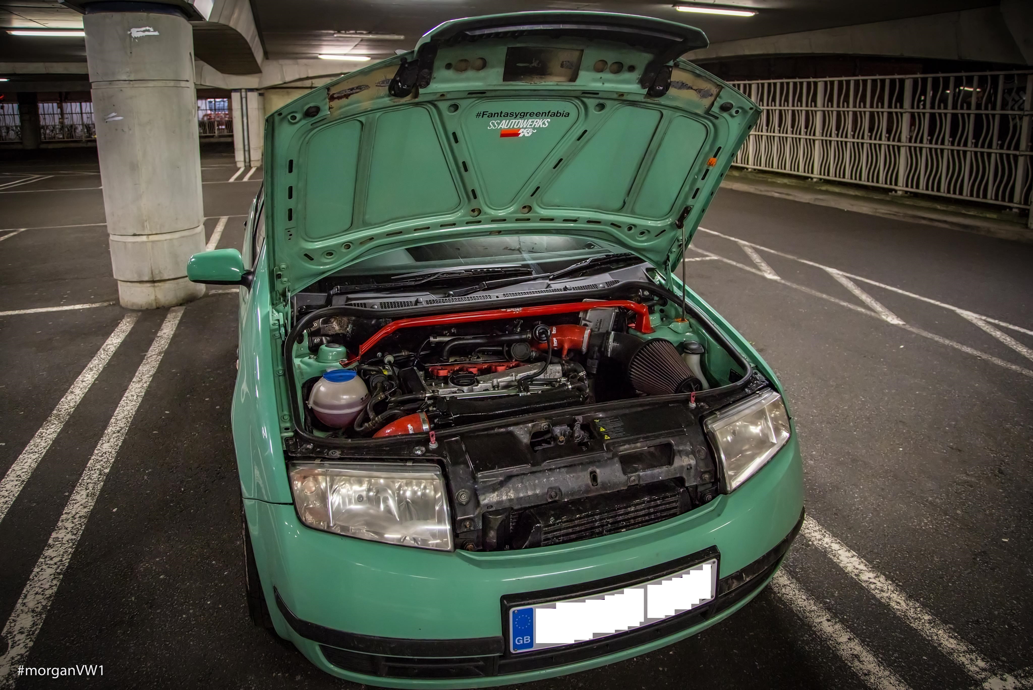

Hi all, can't believe it's been so long since the last update but thought it was about time. So we managed to fit the 6 speed gearbox from a audi a1 petrol - few things needed changing but it works a treat. Always seems to drop down into the power band and just keeps going. Track day went well although started off very wet! Everything on the car seems to have bedded in nicely though. Since the track day I have been driving it every now and then however life has got really busy and I am now actually moving abroad for a while which means no more minty for me. The good news is that after all the sweat, money and back breaking work that's gone into this build my friend who has done a lot of work with me has taken ownership, so she is in good hands. This won't be the end as I will be back regularly and plenty more road trips in the future. I also have a Octavia r32 project that needs to be finished at some point, however working away means everything has been paused for now. Some pics from the track day; And of the next project - current state;

Time for a little update, so I'm booked on the Snetterton track day this coming Monday... In the last few months I've had a few things go wrong, wheel bearings started causing issues, driveshafts are not happy and I went through another gearbox since Worthersee. The 5 speed doesn't seem to be able to cope with the lightened flywheel and spinning up so quick... On Monday this week the work started - nothing like working under pressure A 6 speed gearbox is currently going in (trying anyway) with new clutch and flywheel, wheel bearings are being done, drive shafts, full service etc etc. Not much at all

Also managed to do a top speed run on the autobahn - and the wheel trims stayed on With the 5 speed box that's all she could do, nothing more to give.. She does struggle with engine temps on full load runs a bit. It's something that's being looked into but cools down quickly again when driving a bit more "normal"
Since getting back the gearbox has been changed to the spare one from the Ibiza donor car - all good again and back on the road;
So it's been a very long time since I have updated this! Been manic with changing jobs and all sorts of other stuff. So all the prep work that was done previously was to get the car ready for the Worthersee trip - I'm pleased to say she made it there and back! The gearbox has been noisy for quite a while before we went but the mountain twistys killed it off.. drive back was long and slow(ish) but she done her job and got me home. We covered about 2600 miles through France, Belgium, Germany, Austria, Italy, Slovenia and the Netherlands. Worthersee is very "scene" so minty stood out like a sore thumb - however that was the beauty of it, people were intrigued and asking lots of questions - and of course laughing lots So lots of pictures;
