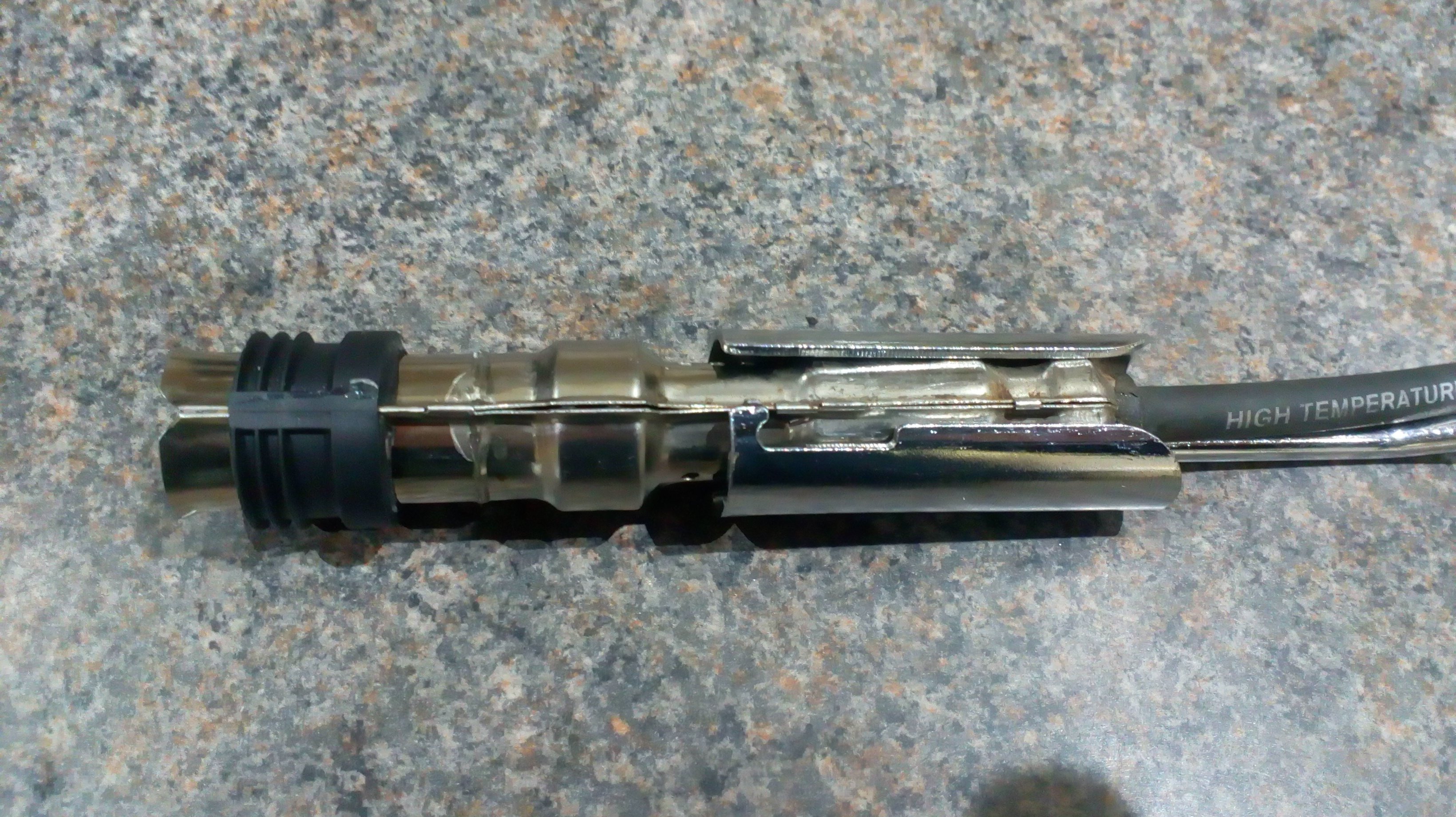

  21. Interesting thread this for me, as I've had a similar problem with Fabia 1.2 TSi and had to replace the ignition leads like you have. I'm wondering if that rubber on spark plug one is something that's been left on from a previous spark plug or lead change and maybe if you'd got that off and replaced the leads all would have been good. I know that when I was replacing my plugs, the rubber insert inside my 16mm plug socket would always stay on the plug terminal and I had to use long pliers to retrieve it; it's possible that could be what the rubber piece left on you No 1 plug was. In my case, 3 of the 4 metal sockets inside the ignition leads broke off and were left on the spark plugs. Did you use a special tool to remove the metal ignition lead boots?

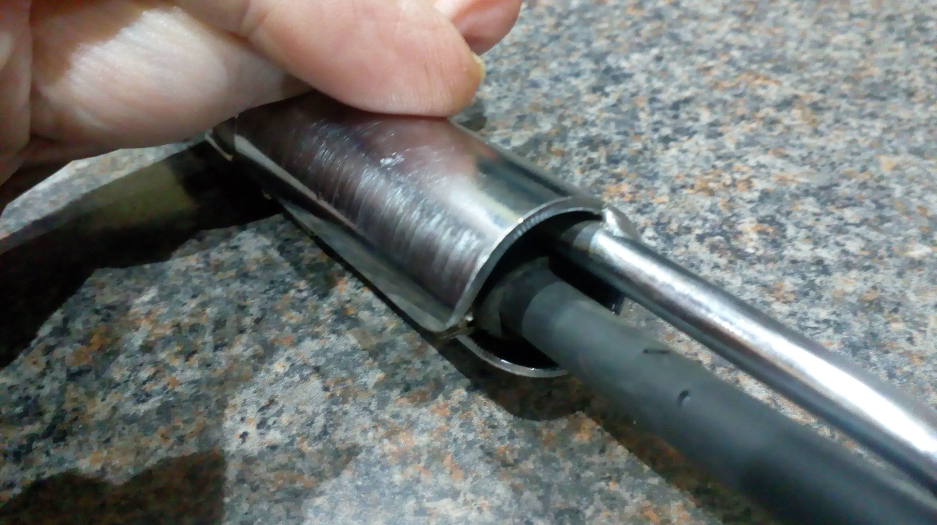

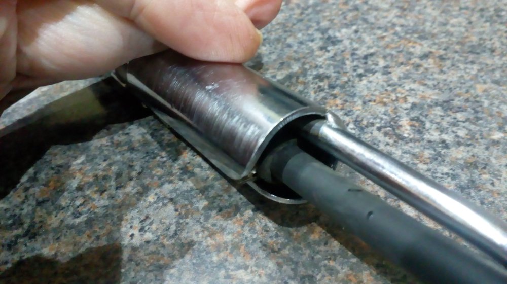

  22. I bought the above to remove the ignition leads on my Fabia 1.2TSi CBZB engine, in order to remove the spark plugs. This tool is not suitable for the boots on the ignition leads fitted to this engine. I couldn't understand why until I read some of the reviews on Amazon. Basically, the handle is welded to the inside of the functional part of the tool and the metal rod of the handle stops the tool going down far enough for the tooth to engage with the lug on the metal boot. Apparently it works ok on Smart car engines; presumably the boot size is smaller. I'll post a picture if I can to demonstrate. Uploading Attachment...
