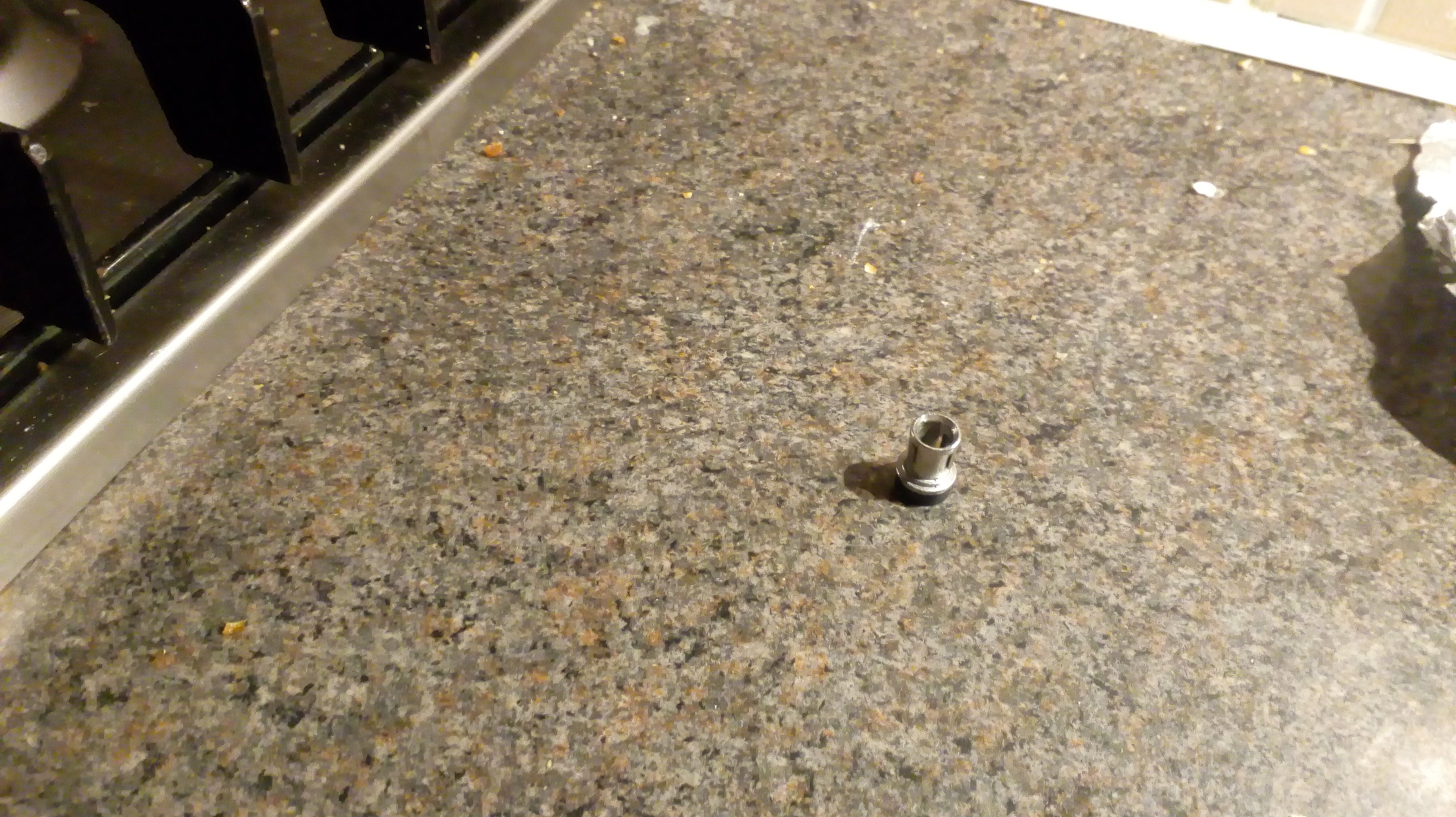

  23. Local garage (does my MOT's) sourced them from TPS for me. They're 84p + VAT = £12.10. VW dealer expected me to drive down to pay and go back again to collect when in stock; got the impression they weren't too keen to help out. They're surprisingly small;
