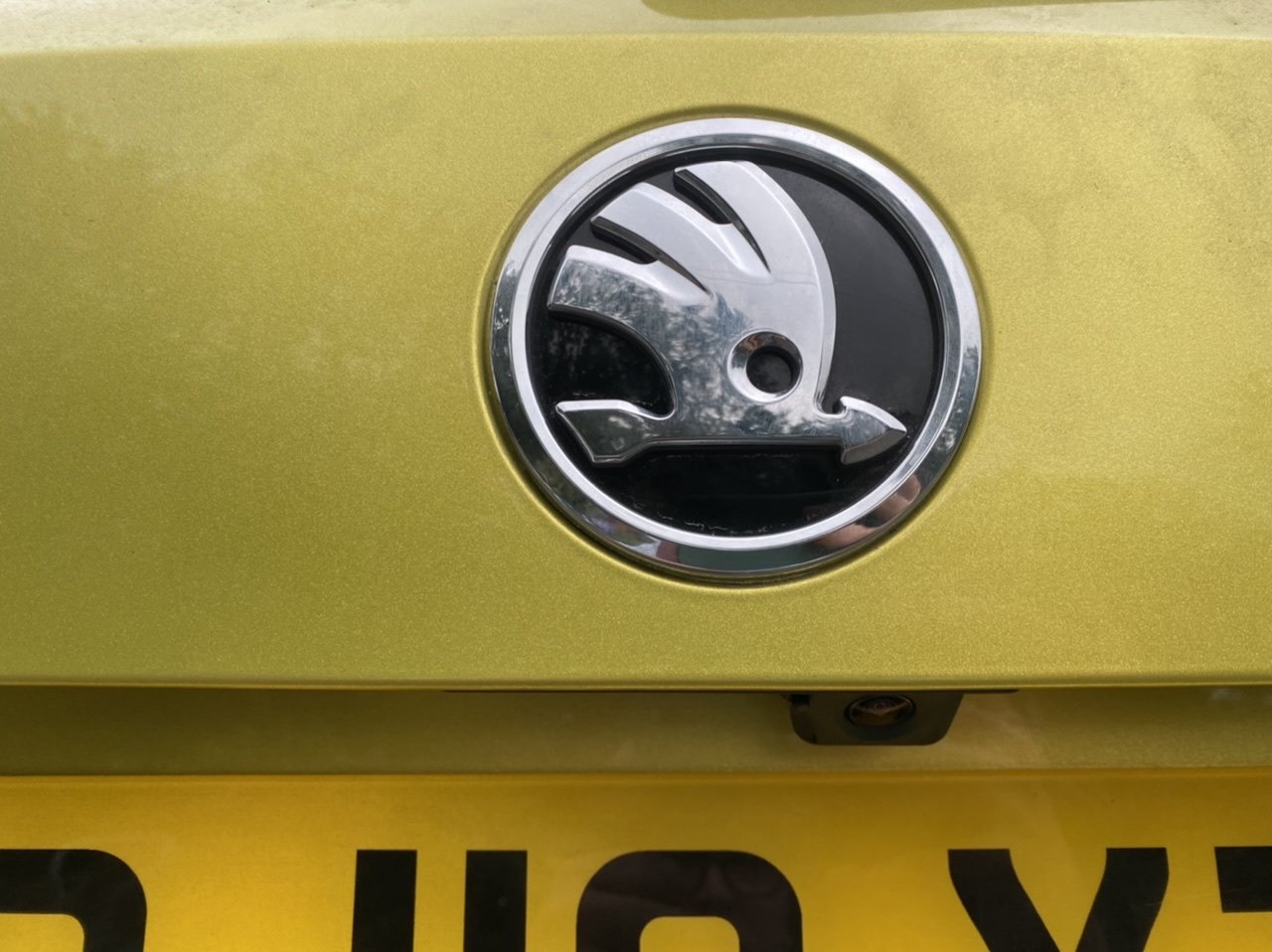

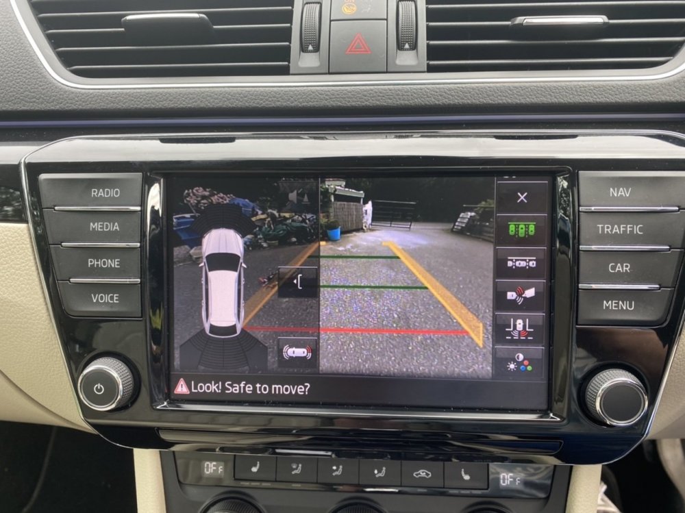

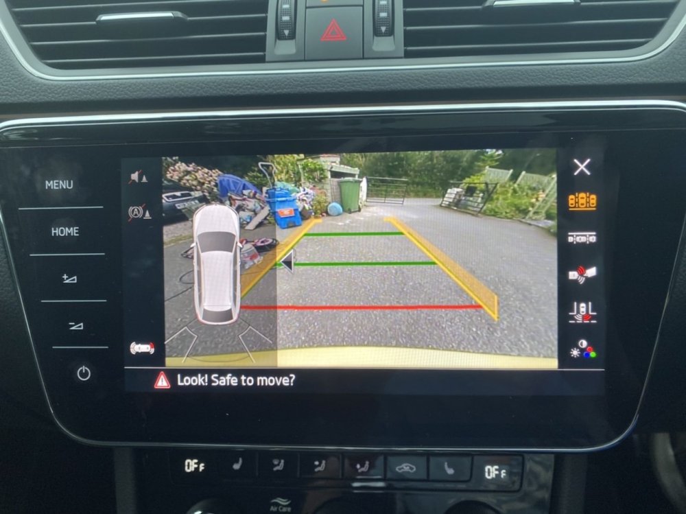

I paid £477 and mine has the lines and I can press all sorts of buttons so I can see backing out left and right
the lines move with the steering wheel too and tells me when to turn or what ever. No idea about a washer jet? Where would I look?
Put the car in reverse and wash the rear window, you should see the water cloud the lens

Thanks for the photo! I like how the dynamic guidelines move according to your steering, and I believe those are the two to three camera modes (one regular, one ultra wide, one top down for a tow bar).
I imagine that they ordered from here: https://eshop.skoda-auto.sk/en_SK/rear-view-camera-superb-iii/p/3V0054634
It does seem to match the one in your photo and it seems like there isn't a washer jet.

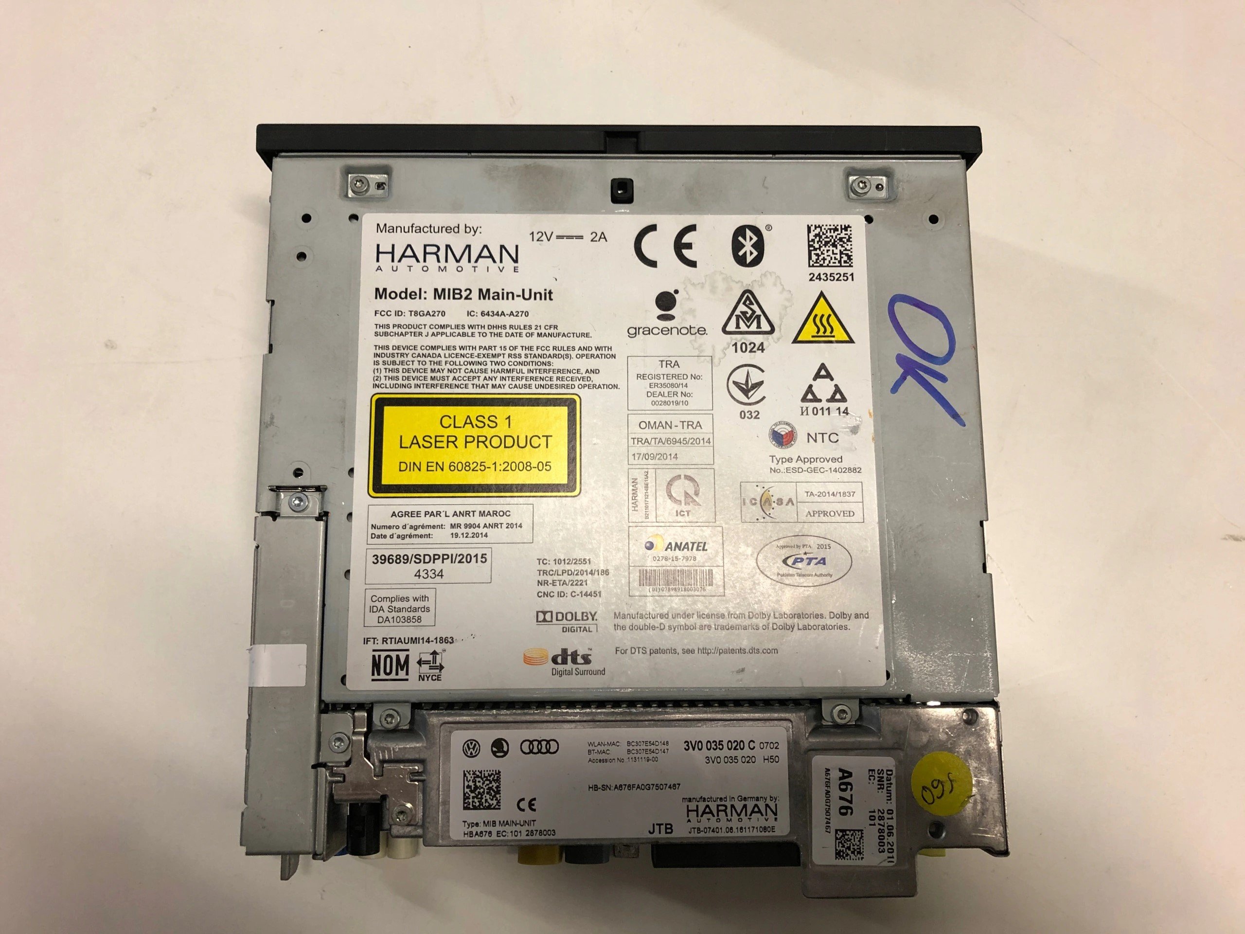

I believe this depends on what code your head unit has, if you can pull it out there should be a code on the back plate like on this example (3V0 035 020 C😞 3V0035020C.thumb.jpg.f100af2134c58607463f0f5607453e7a.jpg

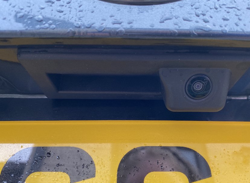

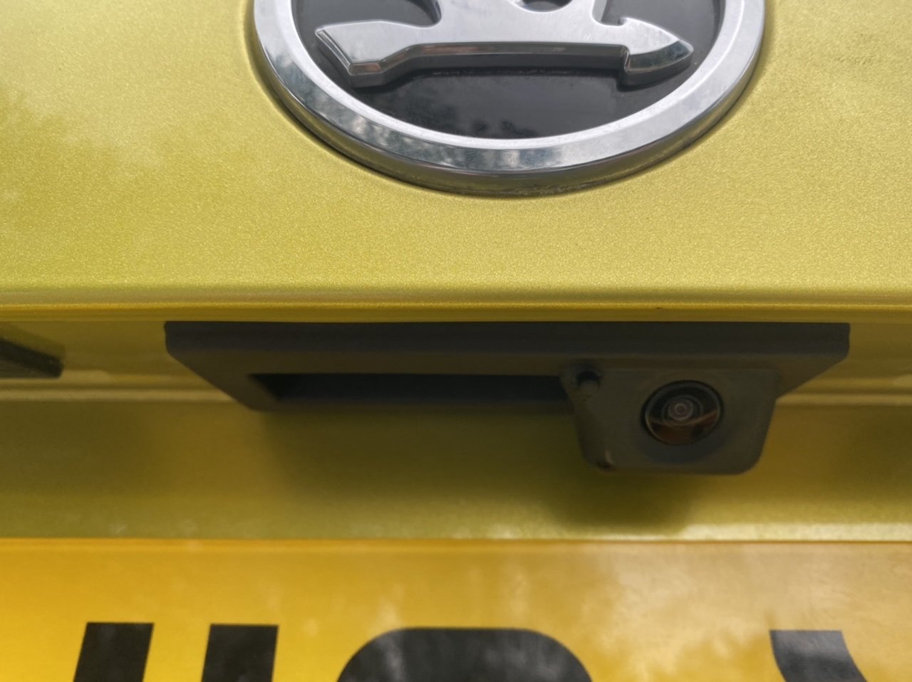

Check your boot handle, if it is a perfect rectangle you can use any camera that is in a 112x48mm handle with the correct dataset on it so on the blue car there I used a 5E5827566G handle and the green car had a boot handle with curves on the outer edge which needs a Kodiaq handle, 566054634A. Unfortunately I’m not planning to come to Jersey but if you don’t have VCP yourself make sure the correct dataset has been loaded onto the camera you order. Both part numbers above are Highline with washer.
Wonder should mine have come with the washer then? Or did I need to specify this? I just said I want the reversing camera? I don’t mind as I said I can wipe it each day etc
Camera with washer is an extra and most of them don’t have it but I only fit them with the washer. You can retrofit the washer to some cameras without it, just drill though the handle in the right place and plumb in as you normally would.
