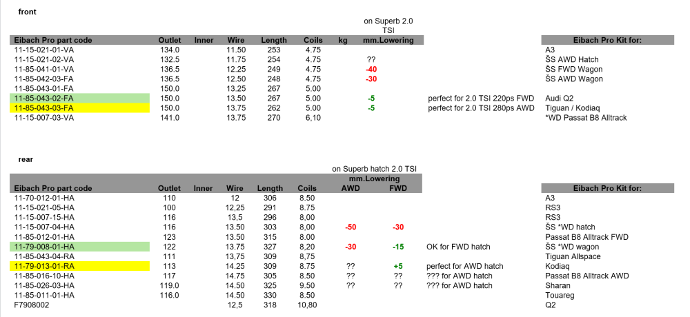

going to experiment - stiffer Eibach Pro springs without lowering
for rear axle on 2.0 FWD can be installed springs from 2.0 AWD kit
result is perfect:
mm.Lowering
Eibach part code
Outlet
Wire
Length
Coils
AWD
FWD
11-15-007-04-HA
116.0
13.50
303
8,00
-50
-30
11-79-008-01-HA
122.0
13.75
327
8,20
-30
-5
but which Eibach spring will give less lowering on the Front axle?
hardiest for Superb is 11-85-042-03-FA, but the same spring model goes for lighter versions of Audi Q2; VW T-Roc.
what makes me to guess, some of the next springs can give me searched result - stiffer without lowering
Eibach part code
Outlet
Wire
Length
Coils
mm.Lowering
11-85-041-01-VA
136.5
12.25
249
4.75
-40
11-85-042-03-FA
136.5
12.50
248
4.75
-30
11-85-043-01-FA
150.0
13.25
267
5.00
11-85-043-02-FA
150.0
13.50
267
5.00
11-85-043-03-FA
150.0
13.75
262
5.00
Eibach part code
Superb
Passat
Arteon
Golf7
A3
Q2
Tiguan
T-Roc
F11-85-041-01-VA
985
1100
1110
1100
1100
995
1020
F11-85-042-03-FA
1180
1180
1200
1065
F11-85-043-01-FA
1090
1090
F11-85-043-02-FA
1160
1160
F11-85-043-03-FA
1220
