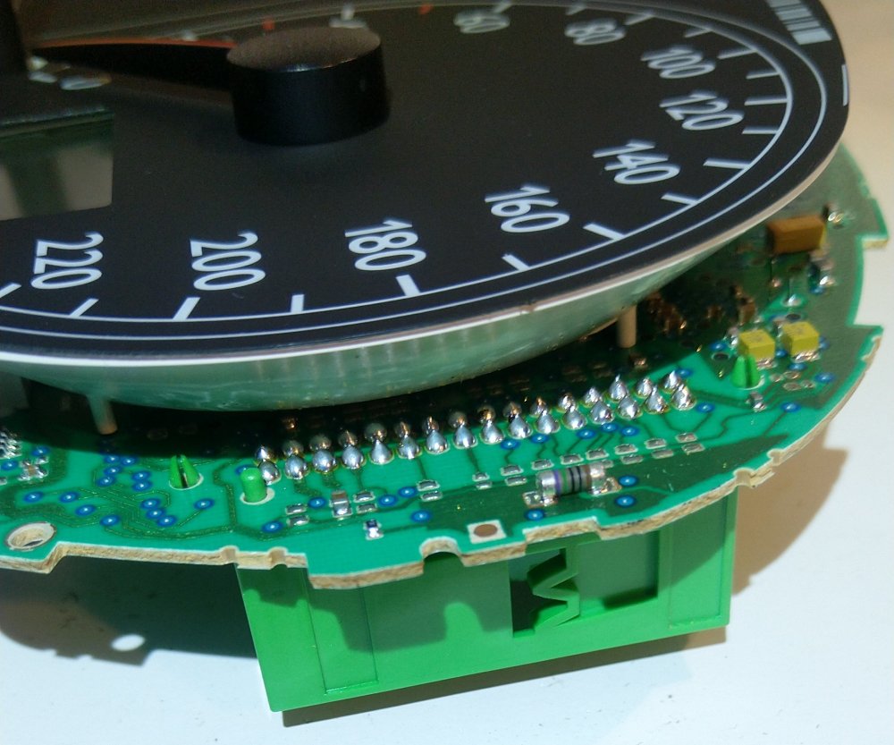

Another common problem with connections to the instruments module is spurious coolant shortage indications. This doesn't always get fixed by replacement of the expansion tank. The level sensor feeds in/out at pin 16, at the bottom/opposite end of the same connector.
The mating connector locks into the PCB connector so any movement/vibration of the wiring loom will tend to waggle the whole connector on its solder joints. I think it's  reasonable to expect that the end joints would be most stressed/strained?

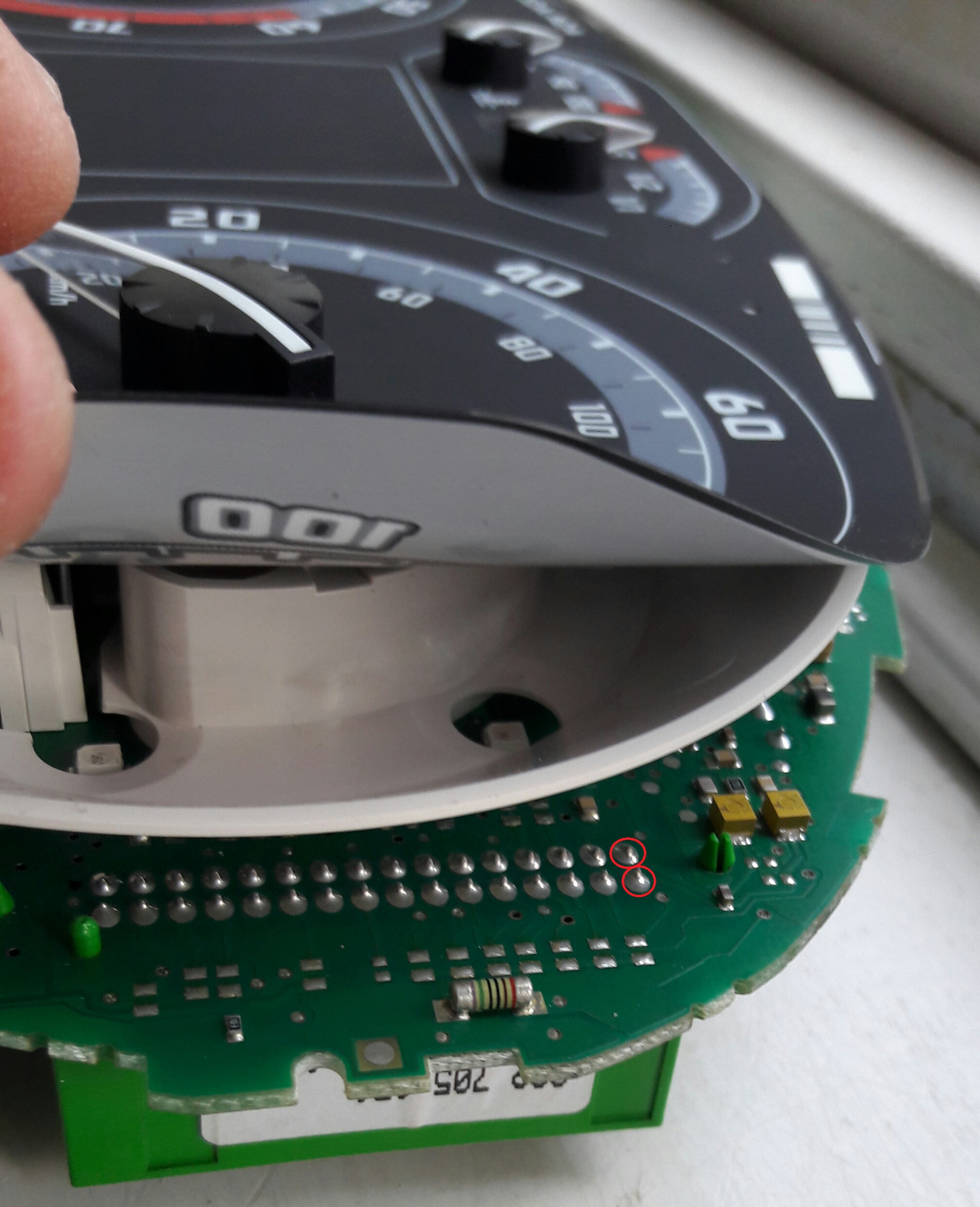

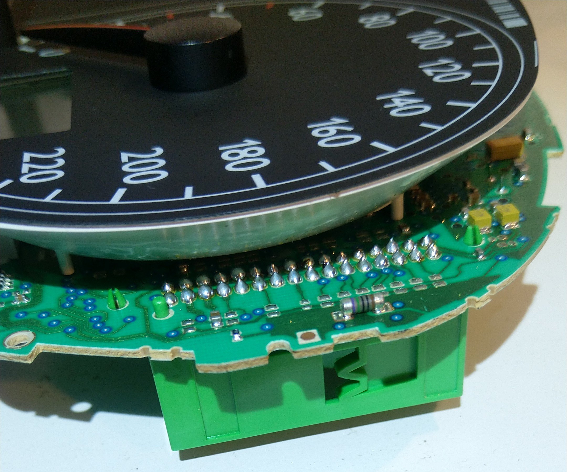

Just been looking at a spare cluster I have, and sufficient access to the relevant pins of the connector on the PCB can be had without much effort. There's a piece of plastic trim above the steering column that unclips towards you to reveal two Torx screws. Remove them and pull cluster towards you. Release two wiring connectors (the big one has a lever type latch IIRC, the small one has a plastic flap that has to be pulled out, away from the connector body).
Take indoors and release the 7 plastic ramp catches from the periphery of the rear cover. Remove PCB with bezel, needles etc. all still attached.
Lift the right hand edge of the bezel and you have a view of the back of the green connector, where the solder joints (may) need re-flowing. Take a soldering iron and carefully apply to each of the red-circled joints, along with some flux-cored (standard) solder. Avoid joining any pins together with solder blobs. Clip cluster back together, refit, test.

Ok, so thanks to Wino the soldering has now been done.
Actually quite a straight-forward job apart from;
Managed to drop my tork spanner down behind the dash (school boy error) - which took a few minutes to retrieve.
and
battery went flat while continually turning the ignition for 2 days etc.
There were a few codes in the system (haven't got them written down as of now- will get and post tomorrow) - but they were all immo based and as suspected.
Cleared them down after re-fitting the dash and it's a case of trickle charging over night and then see where we are.
Big thanks for the input and will let you know how things pan out - in case it helps someone else.
