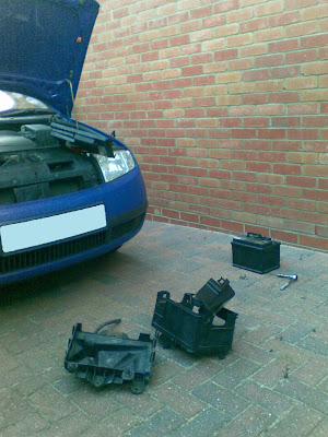

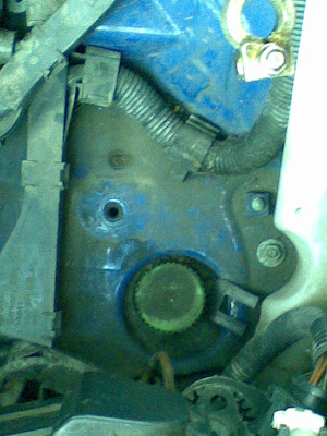

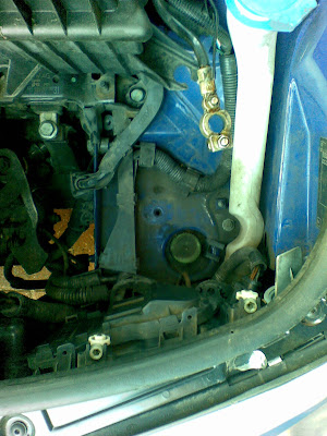

I've just spent the last hour or so filling the power steering fluid reservoir with Comma CHF 11S. Most of the time was spent removing and replacing the battery & associated housing. I'm stumped as to why Skoda decided on this particular design!
Here's a few snaps I took:

I also found a loose nut underneath the housing that might explain an annoying rattle I couldn't track down from within the car. It fits one of the housing securing bolts, obviously lost the last time someone went through this procedure.

Thing is unless its been short filled or you have a leak the level shouldnt ever change hence it being under there.
I just put in what i had in my garage its red what a stupid place to put a Bootle air filter box out battery out and battery Case
Expect a knackered pump and/or rack soon then.
