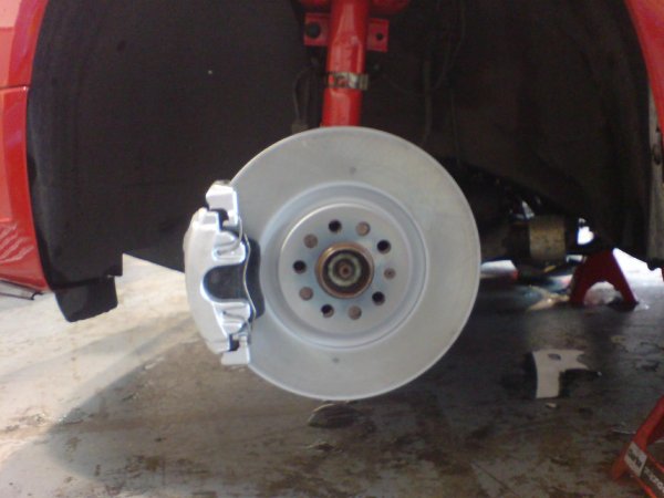

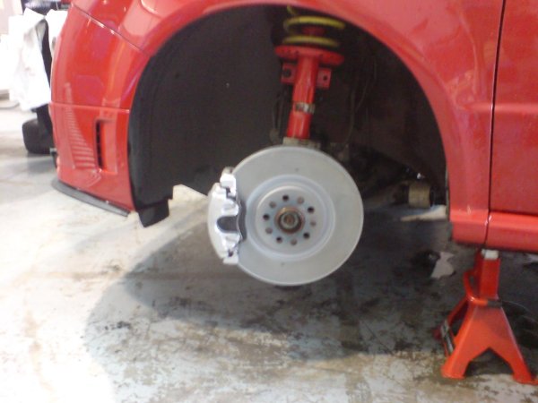

new brakes fitted, 312 callipers from a 225 TT and brembo discs with mintex pads:
really pleased with them considering they are such a cheap upgrade.
your cars starting to take shape very quickly :)
You're not going to paint your brake components then? ;)
Looking good!
the callipers and carriers are painted silver, may do them green one day when I get a chance.
Coming along nicelly!
"Standard" didnt last then!
Blimey - fast work :thumbup:
What's next?? :)
