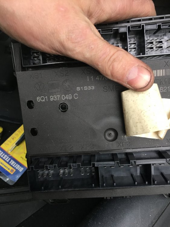

Where is the central electrics unit

On Mk1 Fabia and Polo 9N, J519 is above the accelerator pedal (on RHD cars), below the relay panel. I imagine Ibiza will be the same, if that's the car you're asking about?
So it’s the black box with all wires plugged into it does this need to be programmed into the car or is it plug and play ?

Yes. If you got one from an identical car with all the same options and functions, it would work the same; but if not, various options would need to be coded in using VCDS.
Info about the relevant options here: https://workshop-manuals.com/skoda/fabia-mk1/vehicle_electrics/electrical_system/instruments_gci/self-diagnosis_of_the_vehicle_voltage_control_unit_ii/coding_the_vehicle_voltage_control_unit/
That page is for Mk1 Fabia, I think Ibiza will be near identical, but can't find the equivalent page on that site.

That’s the one I have under the footwell the car isn’t starting and I’ve traction control light on all the time even with ignition off
