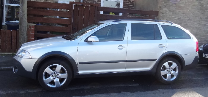

Well, I bit the bullet last week and had all four of my Scout's Proteus alloys refurbished.
There were only two that had delaminated but I didn't want mismatched wheels so had all four done, especially knowing that it would only be a matter of time before the other two followed suit.
One was leaking air so bad was the delamination around the rim.
I really thought long and hard about getting them diamond cut again but decided against it as this car is a keeper and no way will I be refurbing the alloys again in its life time. I was sad to loose the great polished finish but now they are fitted with fresh rubber I'm happy with the results.
I asked for the brightest silver they had, they were sandblasted, powder coated and then painted silver.
SEM alloys in Sunderland (a very good reputation), £65 inc. VAT each (17") so £260 plus £520 for a full set of Dunlop Sport SP01 tyres.
They've done a great job....
