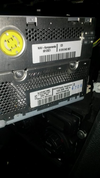

I saw a video on Youtube where the code was actually printed on the sticker. I have a printed code on my sticker as well, se attached photo, number in blue.. Maybe I`m lucky? But the radio works without the code in my car, but not in a different car whos owner wants to buy the radio.. Would the radio ask for the code if I disconnect the car battery for a while?

I disconnected the battery, and was then prompted for the code. It was not the blue number on the stickers, so the radio is now locked..
Your car should remember the unit !
looks like you'll have to get thacode now for definite!
Its the skz number they will need !
Yes, the car remembers the code as long as the battery is connected. Also, I have removed the radio and reinstalled it, and no code is required. And yes, I may have to buy the code, though I didn`t find the cod1745 eBay-member. I try once more to contact the Skoda importer, as I think it sucks that I have to pay for the code. The car was bought new from them in 2007. I asked the local Skoda dealer, and they said that the code should have been in the database, but now there is only "xxxx". So somebody did not do their job it seems.

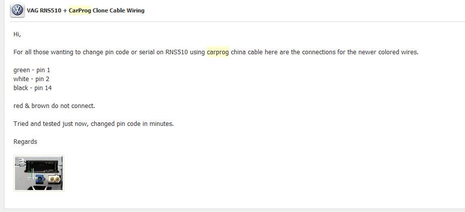

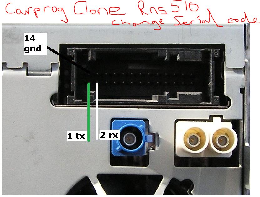

5918c82eb2e2b_Carprogchinarns510adapterchangecode.JPG.07709b79198b8f5eedd17a10df8920a4.JPG
this picture  above is same as the very bottom one, as it was too small to make out,  green=pin1, white=pin2, black=pin14, red and brown not connected/used on china adapter

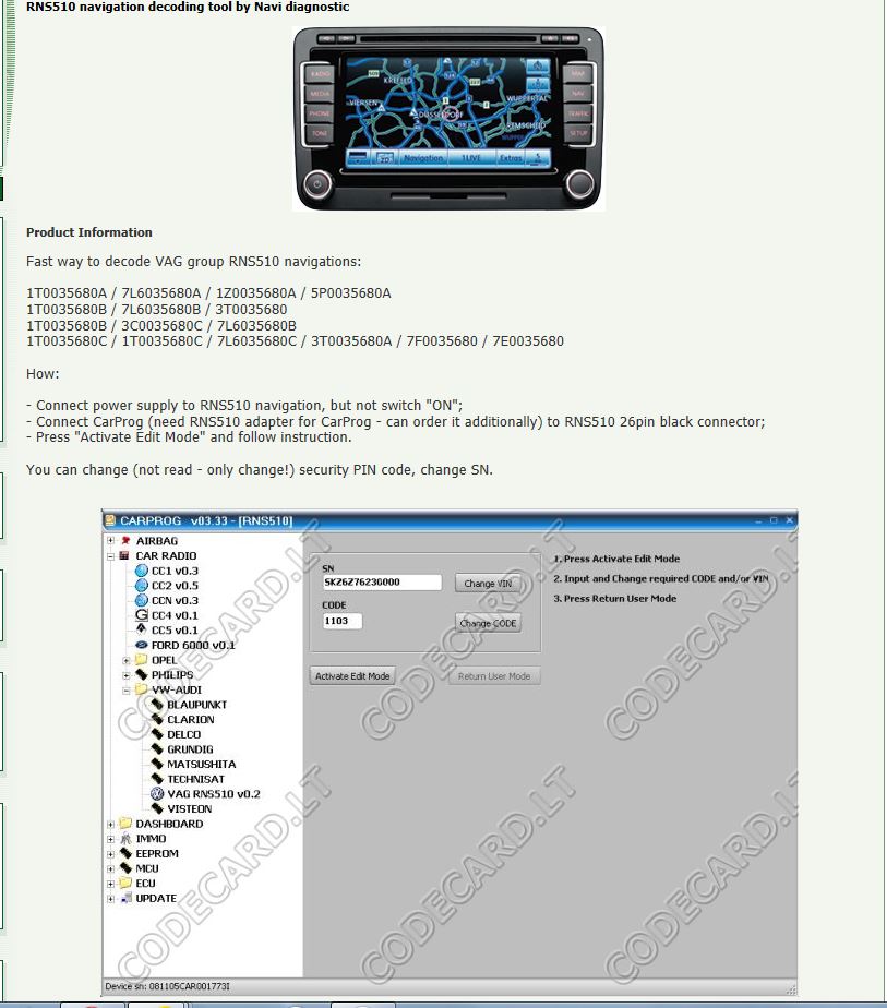

buy carprog 4.71, you can then change the code, I believe cant retrieve the original but can change to a code of your choice, maybe I get my arse kicked of admin for pictures using clone interface, if so I apologise and remove if required, just trying to help people out who are stuck with units they've maybe bought without a valid code5918c0fa37d42_rns510changeserialcarprogclone.thumb.JPG.0079b01bd4794ec37aefa1f02a9932cc.JPGRNS510_adapter.JPG.fde9cf2491cd88a815955a4a4d8c4fcc.JPGRNS510_pinout.JPG.b1eb5e89d04ccee9296f52f1da2a456d.JPGCapture.JPG.e473e77e9042693794a1ead4aa02c7ca.JPG

carprog from china is relatively cheap and has lots of other useful functions, I bought to retrieve my skc for my mk4 and mk 5 golf when I owned those cars, but ive used it for allsorts of other stuff since, well worth the £40 or so I paid for it with 21 adapters, although you've still got to double check the wiring against the originals schematics on there web pages, as the Chinese sometimes have some funky habit to wire odd cable wrong, although I was lucky and only 2 were not correct, and most of the adapters ive never used anyhow

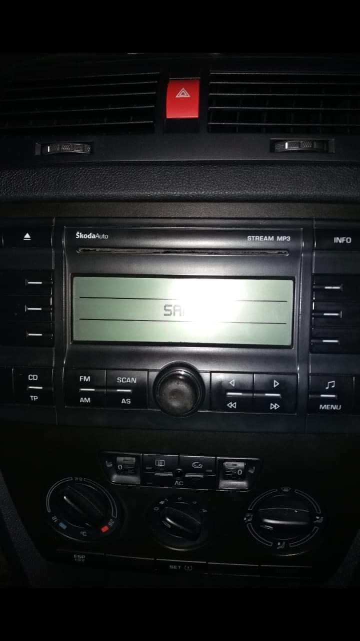

Skoda Octavia 2 2005  please i need code

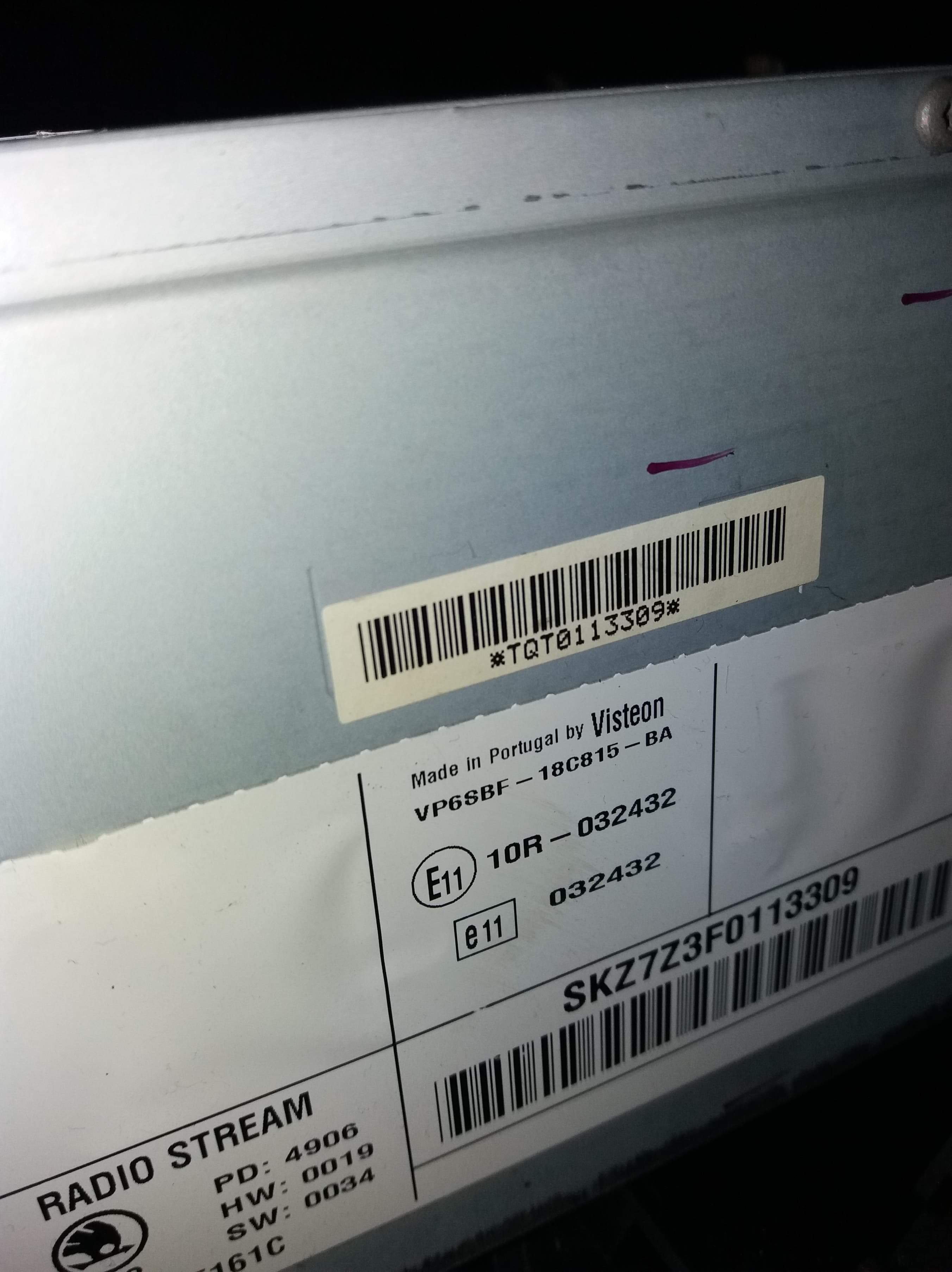

SKZ7Z3F0113309
