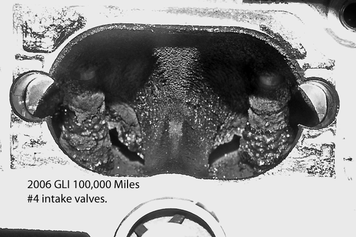

Carbon Build Up is still a UK issue. Its not to do with Oil/Fuel quality in America as the Fuel does not touch the tops of the intake valves on the FSI direct injection engines due to the way the fuelling is setup. If it did we would not have the coking up issue as the injected fuel would keep the intake valves clean. I have a friend who is a Master Tech at a Seat dealer and says he has needed to do a manual clean of the intake valves on several occasions on higher mileage FSI's and TFSI's due to the exact issues being mentioned here.
I have been fighting this problem for the last 10 months of ownership and also the last owner of the car said he had the issue but has worsened since I have owned the car. I have the 2.0T FSI BWA engine but it is also occuring on the 2.0 TSI's from what I have been reading on the forums.
So far I have changed coil packs, cleaned and reset throttle body, changed manifold intake flap runner motor and next stop is the cleaning on the intake valves due to my car being on 100k and seeing a photo like this yesterday from a TFSI engine on 100k - resembles a coral reef!

Don't use cleaner as it will make a 'soup' like carbon solution which will make the job 10 times harder. Obviously it has to be done in 2 stages so you can get TDC using the bottom pulley on 2 valves at a time - so all the crap doesn't fall into the cylinders while cleaning and you blow it out with compressed air or stuck it out with a hoover.
I got the worst of it off (the big lumpy parts) using a small electrical style screwdriver. Then I used a cable tie so get round the back of the intake valve (with the ribbed part against the valve) to get the deposits off the rear of it. Blew all that crap out with compressed air.
Next I used this (http://www.ebay.co.uk/itm/Silverline-Rotary-De-Carb-Brush-Set-wheel-cup-decarb-decoke-de-coke-/181088869824?pt=UK_Home_Garden_PowerTools_SM&hash=item2a29bcddc0) - De-coke brushes on a drill attachment. Only used the pointed one and got that in there on the drill (quite gingerly) and it did the rest. Blew all that out with compressed air. Then sprayed a little brake cleaner in there just to make sure there was nothing nasty left behind and dried it off with compressed air.
Thats how I got to the stage of clean that you saw in my other thread which was good enough tbh and pretty much solved my hesitation issues. Took about 45 minutes per intake valve - would probably take less time if I was really focused on it.
