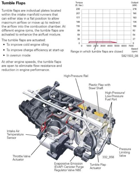

If you look at the image I have attached it shows you when the tumble flaps should be shut and when they should be open. So basically on light throttle and idle (low engine power) they should be closed, then when you increase throttle they open.
As I said when my car is held at a steady 1500rpm (by a MOT testers bar!) the revs move 100rpm (ish) up and down then when you go and look at the flap motor you can see it moving backwards and forwards about 1mm....
