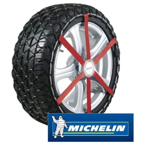

Also a fairly new product on the market is the Michelin Easy Grip composite snow chain.
Appears to be approved as a snow chain and could possible be used where clearance is limited between wheel and surrounding structure.
easygrip

Hi TP,
Many thanks for your post. It has helped me to understand the problem of putting snow chains on my Yeti Adventure 1.2 on with the following tyres 225 50 R17.
As per your suggestion I am going to try using the Michelin Easy Grip composite snow chain.
The easygrip snow chain should fit the tyre without hitting the inside (as you showed in another post) and it's not as expensive as the other products.
Has anyone else tried the easygrip on a Yeti with 225 50 R17?
Cheers
Andrew
