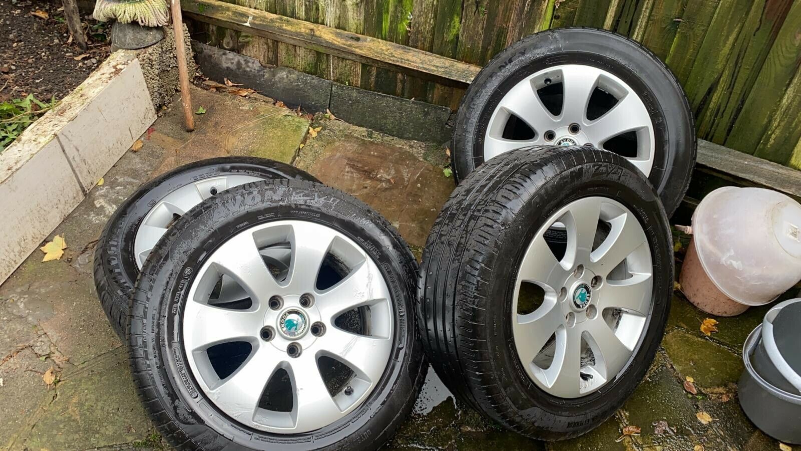

Lots to read on here, but can anyone confirm if some 16" alloys I've seen advertised for sale as 'OEM Yeti PCDx5 112 and offset 45' would fit my 2017 Yeti TDI 4x4 please, or is that not enough information to go on?
Edited by Dale_Stevens
Yes, they should fit.  I suspect they're also 7J rims.

Thanks, I've sent the seller a message asking for the OEM number. Hopefully they will fit.
The code stamped on the back reads..
3TO 601025
7Jx16H2 ET45
My understanding is they should fit ?
That part number is for Skoda spectrum alloys and are correct fitting for Yeti.
I had them as winter wheels on my previous Yeti.
Edited by Kenny R
Great, thanks for confirming.
I've purchased the 16" Spectrum alloys.
I've currently got 17" Skoda Origami alloys with normal tyres, which I was going to clad with All Seasons.
Now I've got the Sectrums I might put some winter tyres on them, and alternate between the two sets each year, or maybe put All Seasons on them. Not sure yet.
