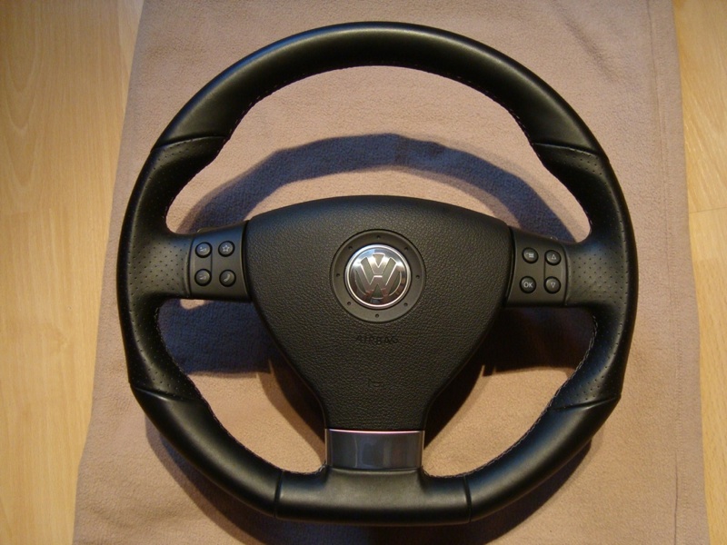

Paid a visit to Shark Performance at Mansfield today, and came away with a big smile on my face :yes:
Thanks to Ben I now have a multi-function paddle steering wheel fitted :thumbup:
I'll have to cope with looking at the VW badge for now, but I can live with that :yes:

any reason why you went for a vw wheel rather than the OE skoda wheel with paddles/buttons?
The Skoda paddle wheel only became available on the facelift interior, and the connections are different to the pre-facelift model.
We (as in Ben, as I'm a complete numptie with anything technical) are still looking into whether anything can be rewired to make the facelift wheel compatible.
As wardth has said above though, now we know a Golf Mk V wheel will fit and work, I might be tempted to get a GTi 'flat-bottomed' wheel at some stage
The Mk6 Golf wheel fits the Mk5 Golf so I don't see why the facelift Octy wheel shouldn't fit.
The wheel might fit, the problem is whether or not the paddles and multi-functions will work.
Having done a bit of research on the subject, I found a site which covered retro-fitting VW paddle wheels, and they seemed to suggest that the Mk 6 and Mk V weren't automatically compatible.
Having said all that, I think I prefer the Mk5 flat-bottomed wheel to the Mk6

Have a look on German ebay for the wheel price - there are loads available, but then you'll also have to get hold of an airbag.
Give Ben (shark_90) a PM to get a quote for fitting
Great, thanks! :thumbup:
Forgot to mention that you might also need a different steering wheel controller, slip ring and airbag wiring loom if you are going from a non -MF steering wheel.
A full scan with VCDS should tell you which steering wheel controller you have fitted currently
So far I haven't cracked it, as there were massive changes in the electronics between the Mk5 and MK6 Golf/Octavia II and FL.

Is there a Skoda 3 spoke MFSW (without paddles - manual car) that will fit a pre-FL Octy vRS? Would't be happy with a VW badge at all.
Edited by willskoda
No there's not, but I am working on using the new Skoda FL RS wheel. It has paddles but I'm sure that's not too much of an issue :)
