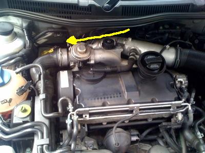

EGR valve gummed up is my bet.
Would that cause a sudden drop ?
It's just started doing it all of a sudden, not a gradual loss in performance or anything.
Although i know you had a passat..so you know more than me ! :D
Could it be the vaines sticking on the turbo, so no boost?
If the EGR is siezed anywhere but fully open then it will cause power loss, yes.
See if you can move the little lever as I've marked with an arrow, and see if it moves.
I'd whip the EGR off and give it a good scrub out, it will be caked regardless.
Thanks Tom.
We'll pop out and give that a try in a while, and see if the lever moves.
As for cleaning it out, i'll leave that to him ! :D
