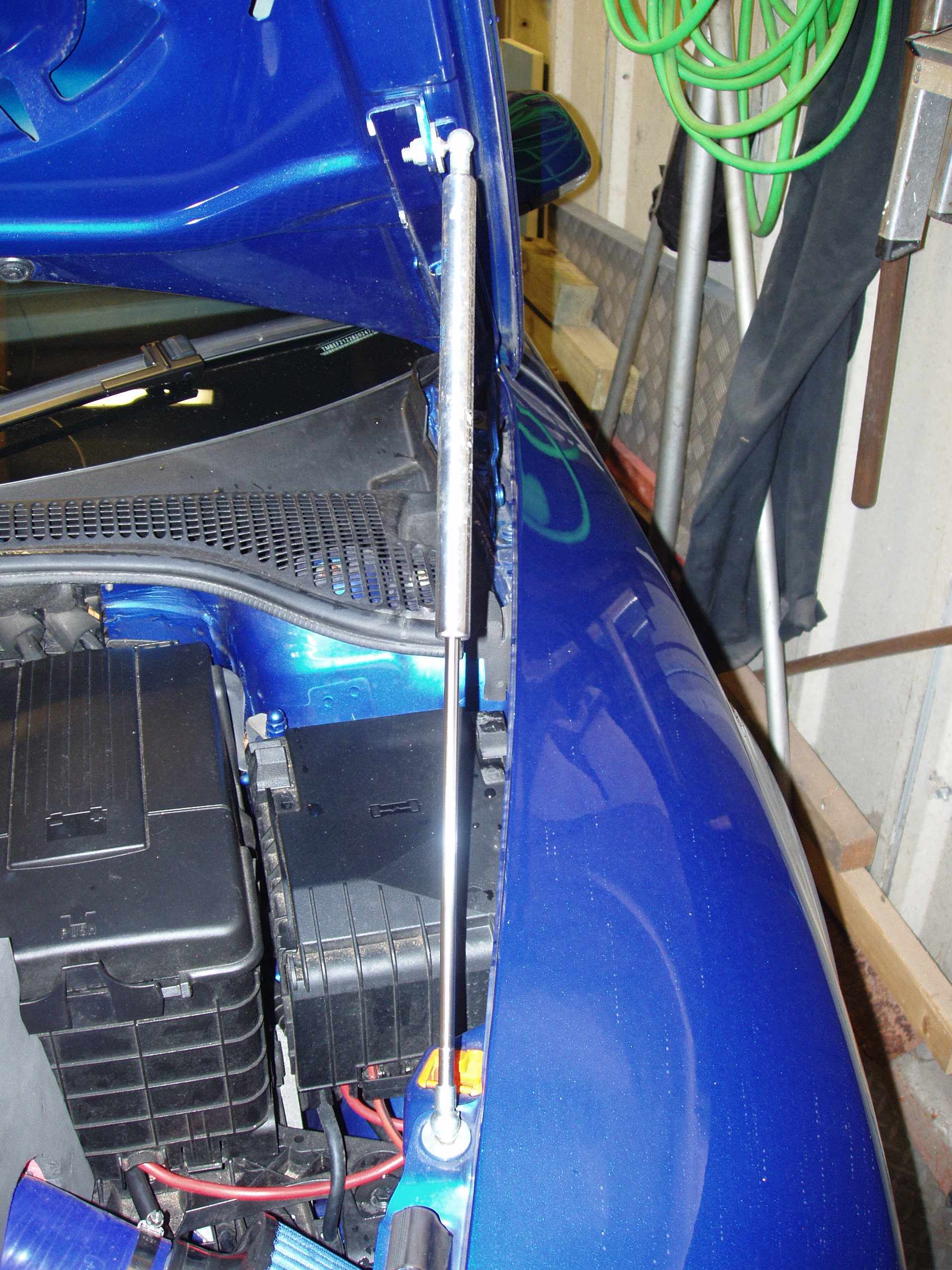

Any chance of a picture??
here is a photo of my bonnet strut, its made by a company called "Milotec"
