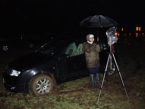

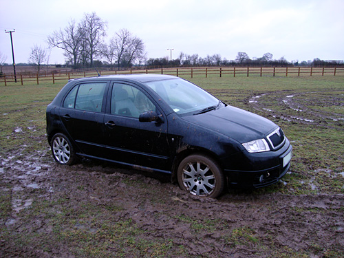

A while ago I posted in the Fabia forum how I got stuck in a wet, muddy field (that to the eye looked like a normal grassy paddock). I needed a tractor to get me out, as even a Range Rover could not get enough traction to get me out. So I am determined my next car will have 4x4 and the Yeti then is of obvious interest (the more I look at other 4x4s the better value the Yeti is looking).

Attached photo shows what floored the Fabia, it doesn't look much does it? A Mondeo and an Aston Martin also got stuck near me, a Discovery and a Land Rover made it out OK. Do you think a standard Yeti would have made it?

Looking at those photos, and with the Haldex system on the Yeti, I would say it would have little problem coping, especially if you can keep moving from the start. I've certainly been through much worse with the Freelander. Unfortunately I'm at work so can't post a link for you.
