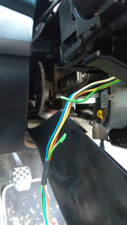

My 06 plate has started doing it, my controls are on the steering wheel not the stalk ??? also my radio controls which are also on the steering wheel don't work, can anybody help
Before you buy a new stalk check the wiring for the cruise control switch.
I was welcomed to this when about to replace the switch:
Fixed the wire and working now!
  • 2 years later...
My problem was a broken wire too. This seems to be a quite possible problem: as the stalk moves it rubs the wires against a (seemingly) sharp plastic corner by the joint of the stalk. Atleast with my car (octavia rs 2.0 TSFI -06), I could fix the problem without taking the steering wheel out. The top part of the cover behind the wheel just lifted up by gently twisting with a flat head between the bottom and top halves. Bottom plastic cover was held with 3 torx screws, one beneath, two behind the wheel. The 2 came visible by turning the wheel after the top cover was lifted. After this i could pull gently one by one the wires to see if any of them were broken. I soldered the broken wire and put it back together. Positively suprised that i didnt need to pull the steering wheel off.
