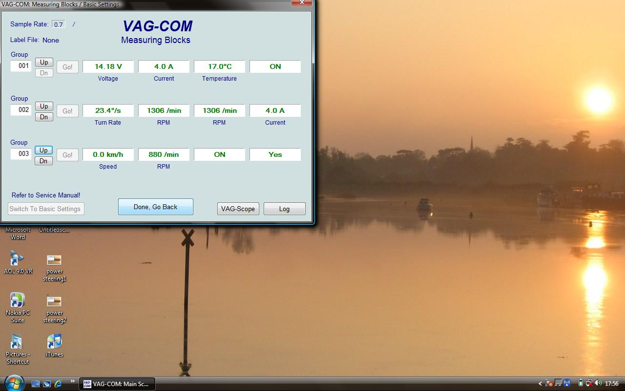

ok been out with old knackerd laptop and el cheapo cable and scanned the Fab, got the usual 00816 Angle sensor (g250) faulty could it be a faulty new sensor?
but also went for a drive and while waiting at lights waggling wheels about I hit Print screen and this is what I got????
Does it mean anything to anyone or just a total waste of time??

Wiring fault or plug not seated correctly?
Inspect the plugs at the PAS end for corrosion. If they are OK fit another steering angle sensor. If the fault comes back it's the pump, and a wad of cash.
