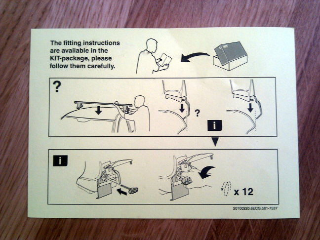

Doh. Just seen that my feet have the latch for the fit kit bar screwed all the way in, out of the box. Once unscrewed it widens the fitting area considerably so I'll be trying the bars again later today.

Absolutely. After untightening the bolts in the feet I managed to fit the Thule bars perfectly using the newer 1594 kit, Thule label this kit as fitting 'Skoda Octavia III Sedan 09-'. I spotted afterwards that the feet had a little note in the box advising that they needed unscrewing before use.. I'll RTFM next time.
