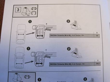

The instruction manual stating a foot location of 33cm on the aero bar

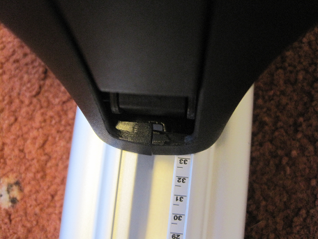

One of the feet attached to the aerobar at 33cm

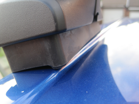

One foot attached (note that it doesn't fit snug at all)

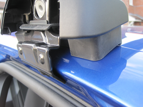

The other end, hopelessly short

I did try pushing the feet out a bit and although that solves the length issue it still doesn't seem to 'sit' correctly on the ridge that it should do. I would also be a bit concerned if I had a failure of the bars that I may have problems with insurance as they're not fitted as per the manufacturers spec.
In 4 and 5 is the bit not sitting right rubber? I wouldn't worry to be honest as all this did on the Bora was scratch the paint!

On the 5th picture it looks like the rubber foot would fit better the other way around, eg the inner edge should be the outer. Is it possible to fit it that way to see if better?
Unfortunately the rubber bit can only go on one way so it's not possible to turn it around. This isn't the right kit, but it shows the rubber bit and it's shape:

But you could easily prove that they correct way is the wrong way. The instructions have probably been type'od or lost in translation. Has no one else got these bars? I am thinking of getting some but now reluctant to do so.

Yeah, I don't doubt that it's a documentation issue rather than a technical one.
