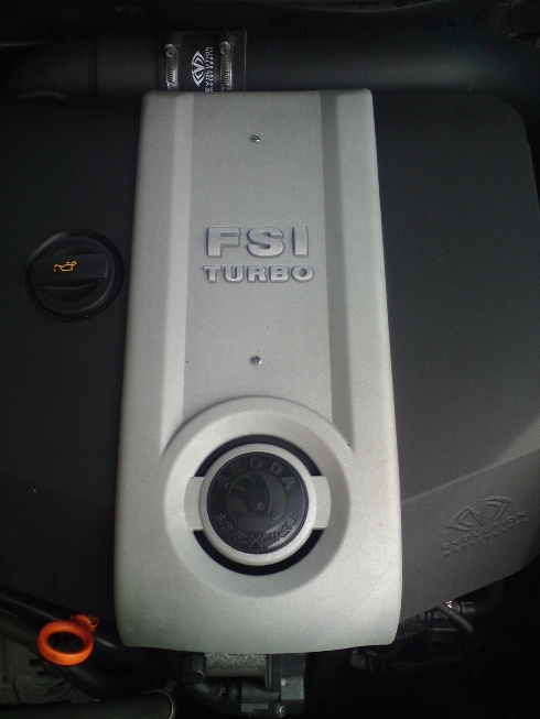

On the subject of fitting the FSI cover, I tried a few different ideas but in the end I decided to bolt it on with a couple if of small M2 bolts. Just for info, make sure you fully remove the black parts that hold the OE cover on otherwise the Evoms cover will not sit fllush and rattle - which it really annoying!!

Yeah, I also found out about the "rattle"! You would really think that for the sort of money Evoms cost, they would offer a better install guide! Or at least an up to date one!! My kit had an all in one 90 degree bend and MAF connecter unlike the download of the fitting guide which said thy were in two pieces!
I've tried very heavy duty number plate tape to hold the cover on, but don't hold out much hope! So i might be following you on the "bolts"!

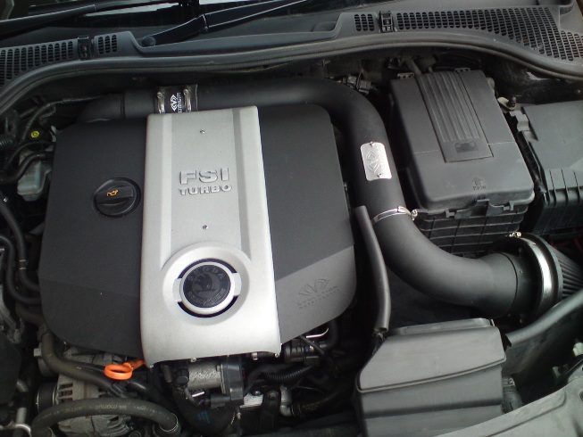

I tried the number plate tape, grippa fill etc, I think the problem is the profile of the cover as it sits about 5mm off the engine cover making adhesion a problem, I would definately recommend the bolt option, I have attached a couple of pictures to show it still looks good fitted this way.
