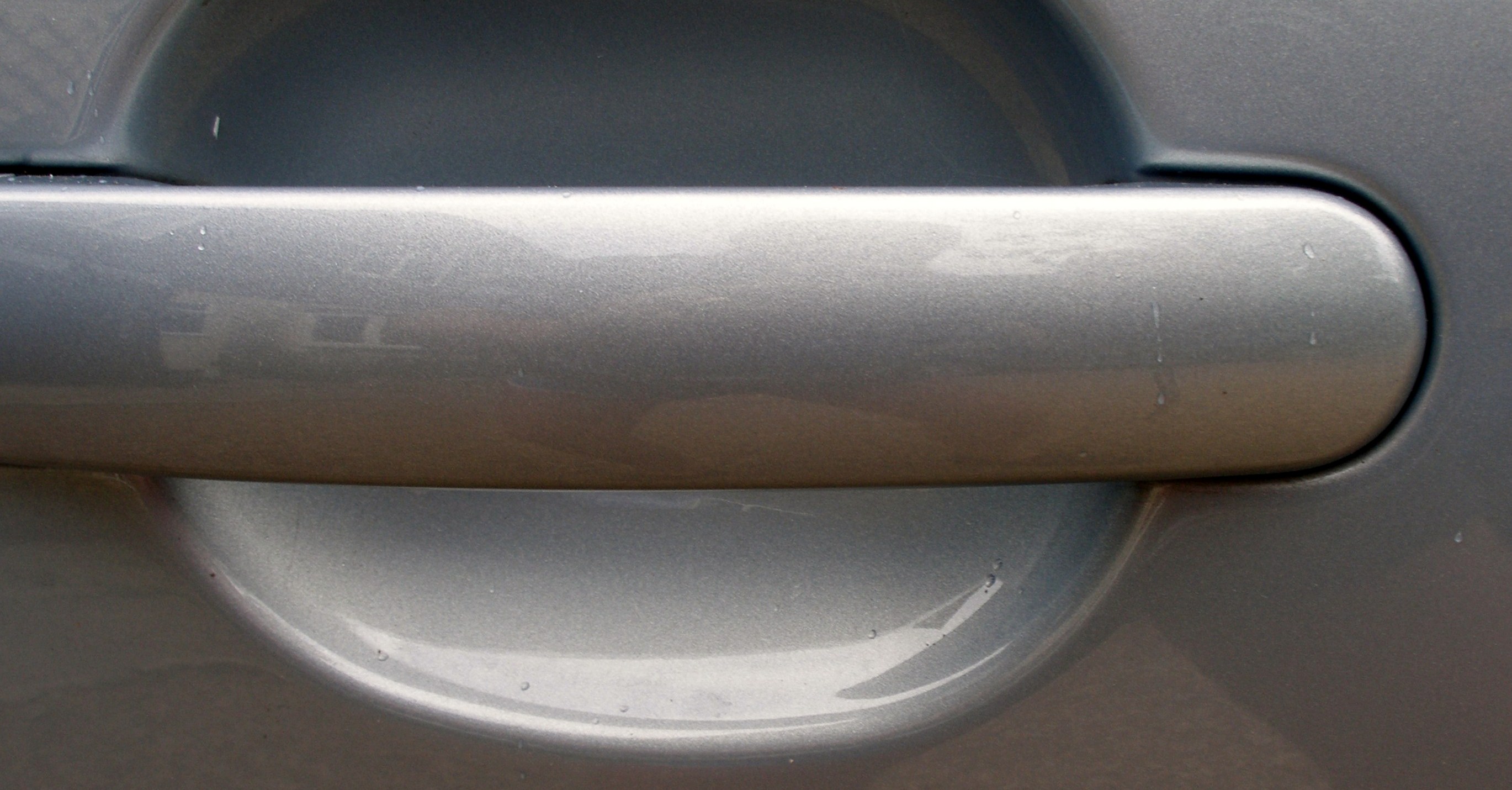

Problem: Door handle rubs door
Here in Russia we have got pretty much common problem when door handle kind of rubs door and remove manufacturer paint from door.
On the picture it looks like grey line
Anybody has the same problem?

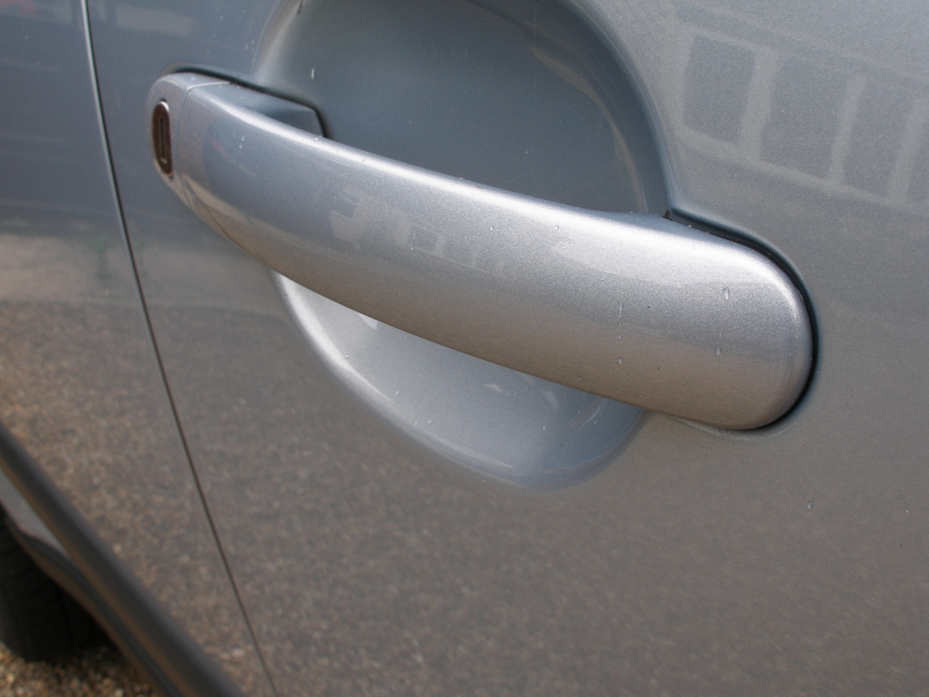

Well I've been out to the garage and managed to get a photo of one of the handles on mine, appears to be OK
Difficult to tell from photo's but would you say the handle is set further back in the recess :wonder:
yeh... looks just fine

Here is photos from Finland and this Yeti is made in Czech factory :( Our dealer was two other Yeti in the hall and both had the same problem.

Just checked my UK spec car and the door handles sit quite a bit further out than shown in the pictures where there appears to be paint damage.
I guess that gaskets or washers have either been omitted or fitted the wrong way round on cars affected. Judging by the photos, I reckon that the diffence is at least 3 or 4mm!

Hi!
That's interesting! I just checked my car, and I can also see some small scrathes just in front of the handle. It's not nearly as bad as on the pics from Karvis, but still clearly visible.

Our Yeti in now only three weeks old and there already are some scratches/marks on the driver's door :wonder: It seems the air gap between the handle and the door is much bigger in the rear doors and because of this the handle never touches the door there.

Here goes with the pictures of the door handles fitted 'correctly'!
yup mine are well away too... :thumbup:
