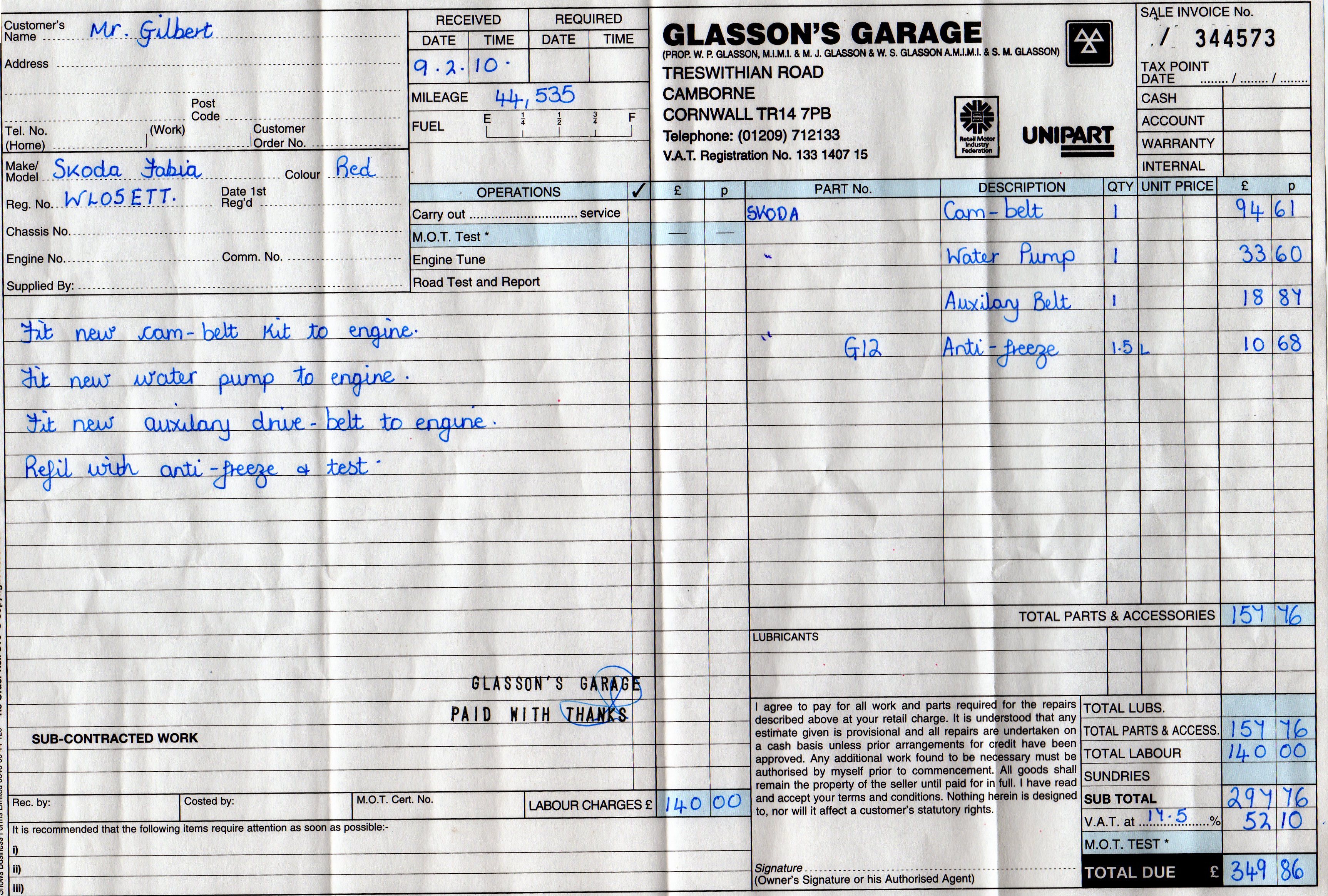

Bill.
Fabia VRS - - - attached 2010 bill.
Thats a good price considering the retail price of the parts to DIY :thumbup:
Suprised to see they did'nt change the 3 engine mounting stretch bolts though !!!
But if the engine has'nt fallen out yet then chances are you will prob get away with it :thumbup:
Bill.
