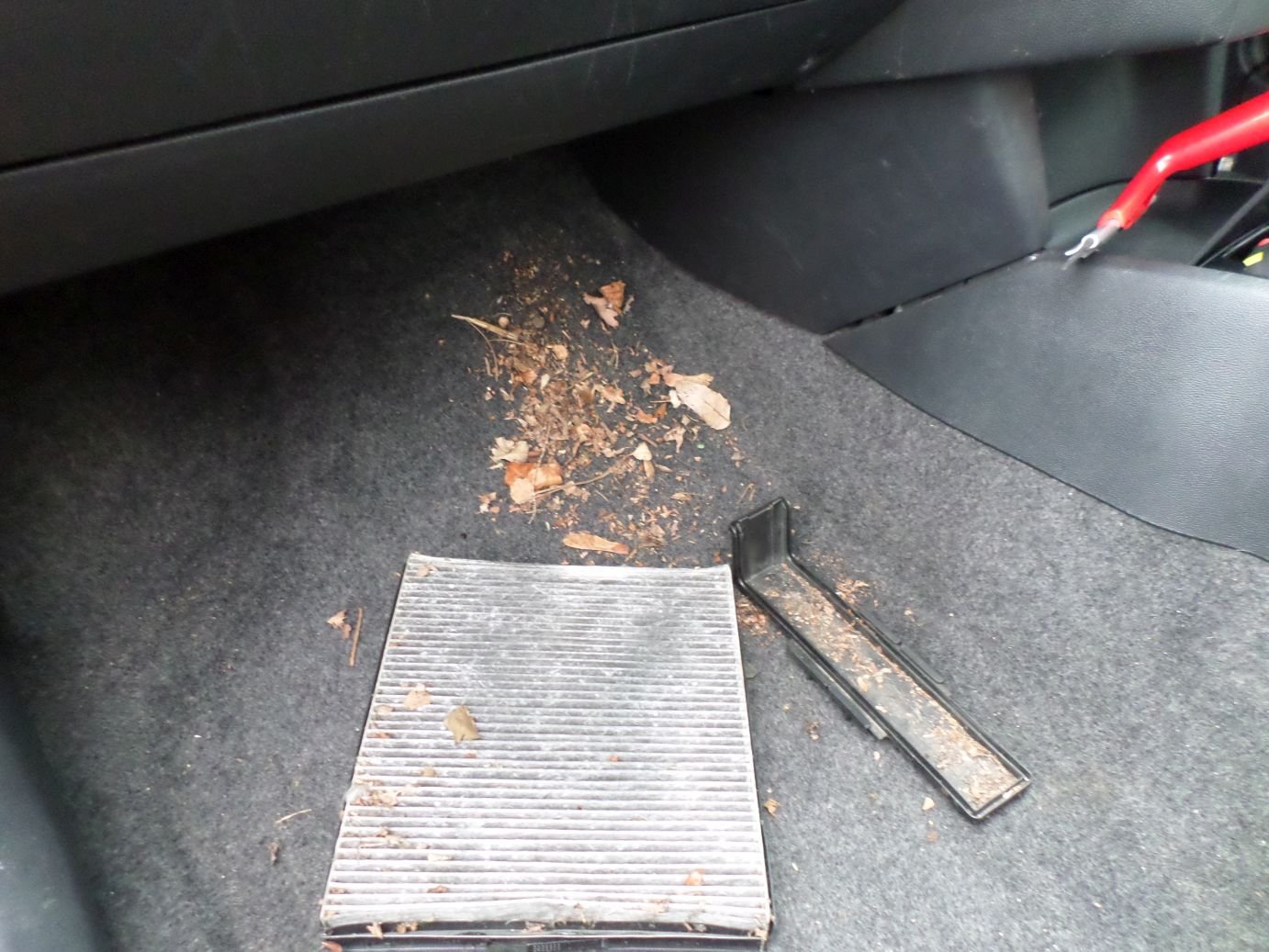

^ It's in the bottom of the heater casing in the passenger footwell and is often overlooked. Here's a video...
you were quite right.
Full of leaves and it's an easy, and cheap, job to replace
