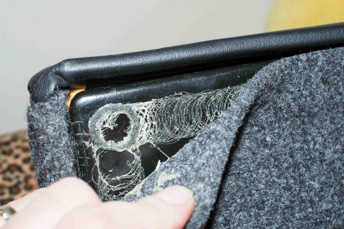

Take out the rear squab. Place on a clean surface, preferably with a soft covering with the rear flat side uppermost.

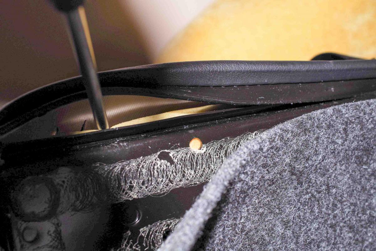

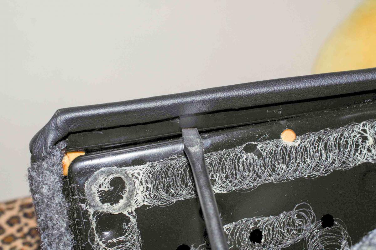

Press a wide bladed screwdriver in between the carpet material and the front seat covering. Whilst pressing down to compress the foam, lever upwards at the end of the top of the seat back. All the front material is attached to strips of plastic which are pressed into a channel around the edge of the metal back.. Don't worry if you bend this channel because when you reverse the process to refit the plastic strips you will need to give a tap all round, preferably with a rubber hammer.
Once you have dug the plastic strips out all round, you will be ablle to lift the foam and material up and hinge it from the top.

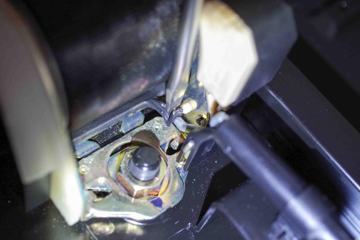

You will now notice that there is an interlock on the seatbelt mechanism which stops the belt from either rewinding or lossening. This is a safety feature which is overcome when the back is fully locked into the upright position. Once you have got this far its plain sailing. Do not forget to replace the plastic guard that stops the foam from interfering with the operation of the seatbelt. Replacement of the seat cover is simple, as you just compress the foam, insert the plastic strips, give a tap all round and bobs your uncle. Took me 25 minutes to get it apartseatbelt fixed, and material back on.

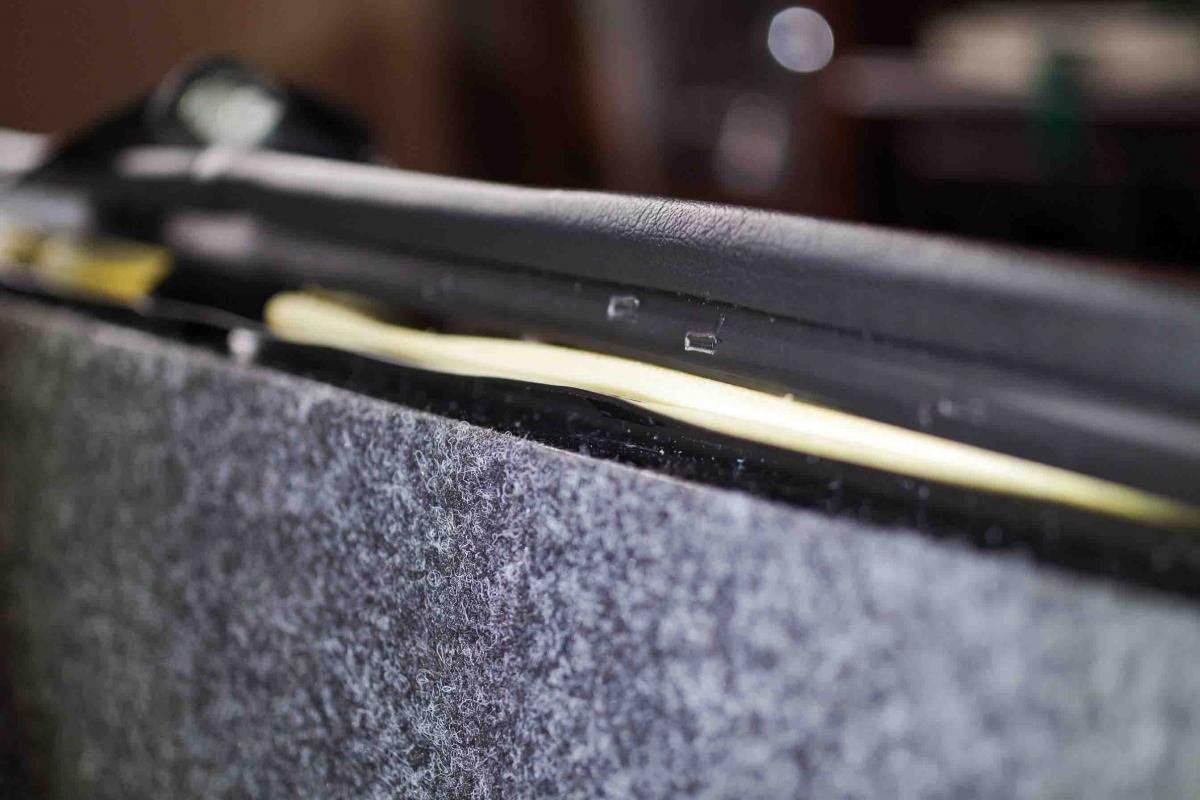

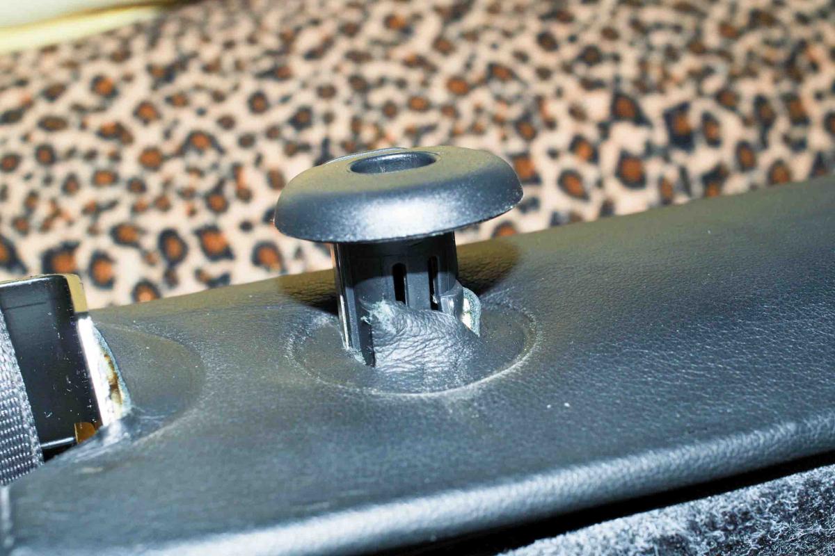

I know that this is old topic but i did have the same problem and with help of this i have managed to fix it and while i was doing it i have made some pictures that could help to follow this guide.

Hi thanks for this thread. I got my rear middle seatbelt stuck after messing I must be that person who has to press the button that says do not press... anyway on the Fabia you take off one of the side white plastic covers and there's a very simple but effective mechanism which is a ball bearing in a plastic hammer which locks the toothed wheel. After seeing how it worked I think you could use gravity to unlodge it. I tried this before dismantling but didn't get anywhere. Anyway thanks couldn't or wouldn't have figured it out with this thread.
