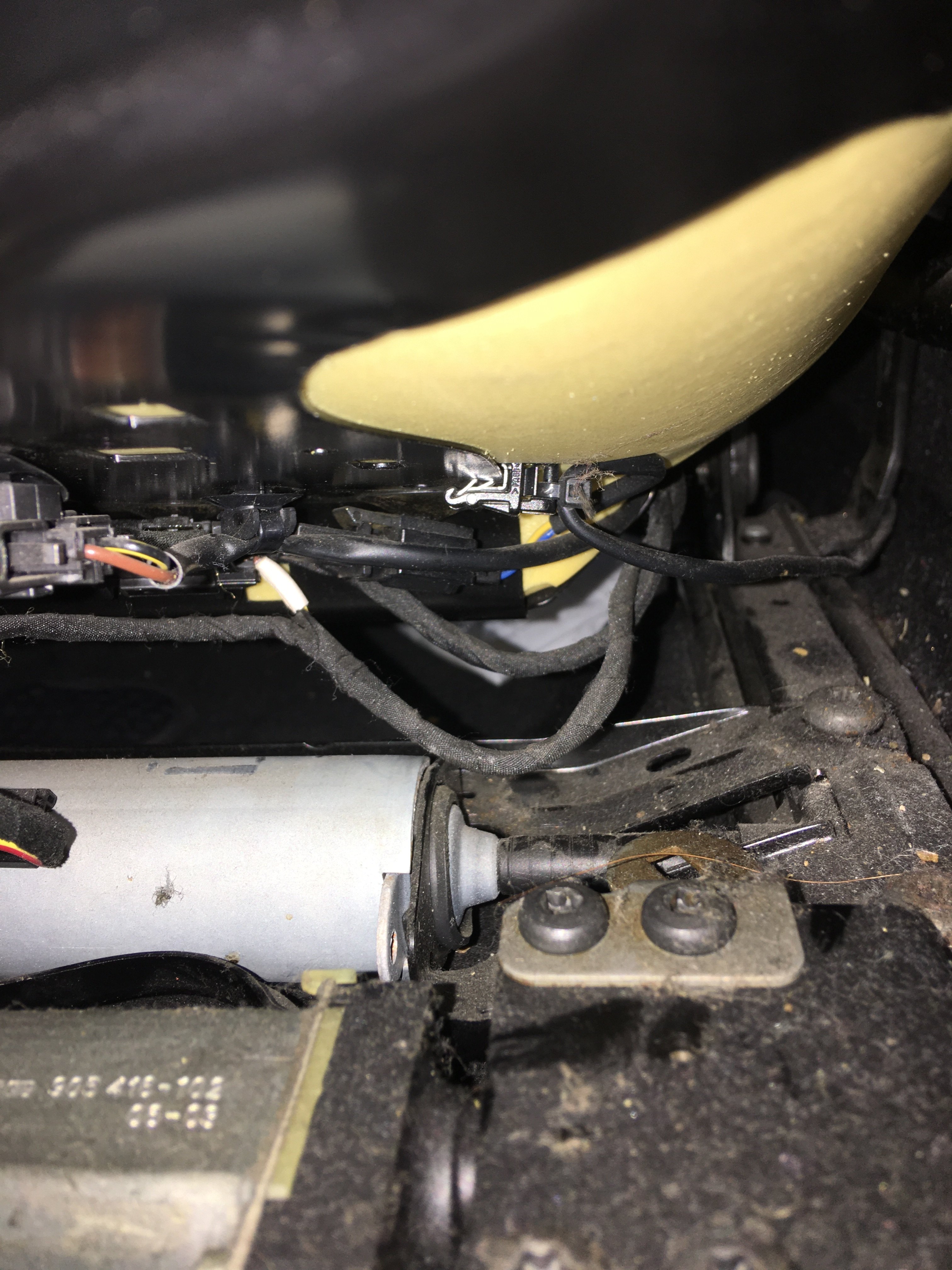

Hi all
As always I search the forum first to find any advice on fixing a problem.
My Octavia 1.6 fsi L&K has the annoying seat belt warning chime on most of the time whilst driving.
the wiring under my seat is different to Picture posted in the above thread .
Below is a picture of my seat
I plan to disconnect the blue/yellow wire connector, which looks to go from the seatbelt buckle.
Not the red/yellow wire connector.
For those that read this thread,  let me know if I am right.
thanks
I sorted it and disconnected that blue/yellow lead and chime (bell alarm) is gone. Happy now 😊

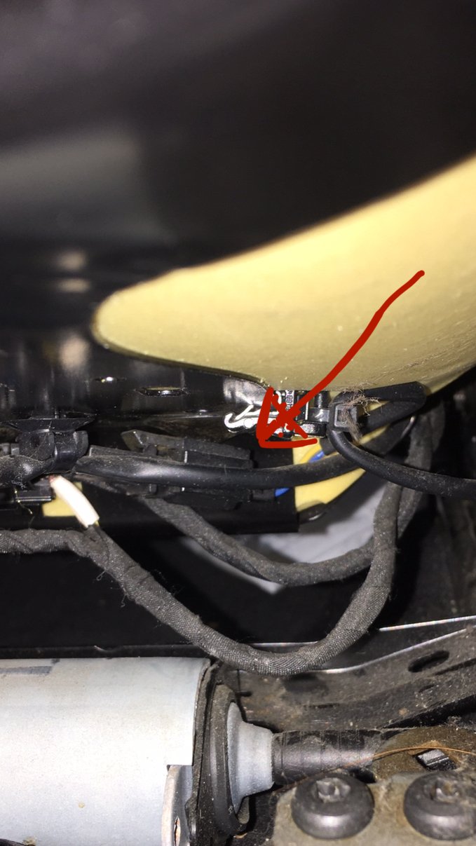

here is a pic (red arrow pointing to lead) for those people who search in future
Yes the 2wire on a mk2 certainly looks like yours tbh I neglected to check the colours 😁
