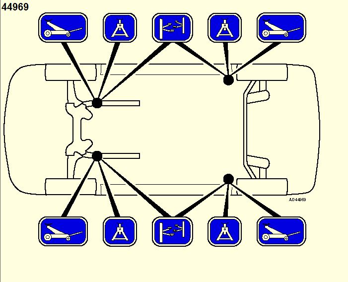

Just had a garage jack my car on the sill when doing rear tyres! I asked them not to but they said al vw's Jack there! Im about to show them the diagram

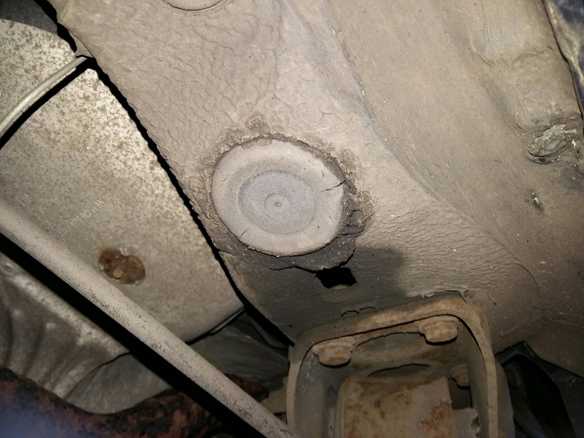

Read about the hockey-puck thing so ordered one, cut out a slot in the middle but still doesn't really feel ok...
I have the feeling that with the original jack, the real jacking point is just behind the sill-lip, not the sill itself if that makes any sense.
With the hockey-puck it feels like all the pressure is on the sill-lip.
pic:
The jacking point is behind the sill. It is made from corregated steel - you can feel it - it's about 25mm x 125mm.

I confirm the points from AUTODATA
In the picture is the jacking point at the front on the sills or just at the back of them

On the front jacking point is there room to jack, place an axle stand then lower the jack? Or should I jack and place axle stands in different locations? If the latter, I would assume it is safer to jack on the sill and place the stands under the frame?
Are you using the trolley jack under the subframe there where the main bolt is and then placing the stand on the main frame?
My sills are like butter and have been mostly squashed by tyre changes (not me).
Unless I can use the trolley jack under the main frame also. How much of the main frame is strong? Feels pretty feeble in some places.
Looks like the place is just before the visible join.
Is there also a small area just behind the sill rail that is reenforced? A slice of wood behind there so the trolley jack sits on the rail and is also supported behind by the wood like on the supplied jack.

Yes, the main frame is only strong towards the front, there is nothing visually to mark where is strong and where isnt just keep as far forwards as possible and its okay, anything around the middle or rear section might cause it to give. I've now bought a polyurethene puck thingy that sits on the jack and aborbs some of the pressure so im back to using sills.

I think the main point is to use the jack stands at the designated points. Jacking should be done (in the case of the front) just behind the designated points, and (in case of the rear) use the tyre change sill lip. I would say never use the sill lip for axle stands, especially if you are working under the vehicle.
