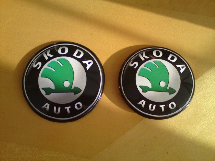

I changed mine for my own design back and front, the back was quite straight forward to remove, I just run a piece of fishing line behind it, bare in mind that there are 2 x lugs which centralize the badge on the boot, so just take your time and work around.
