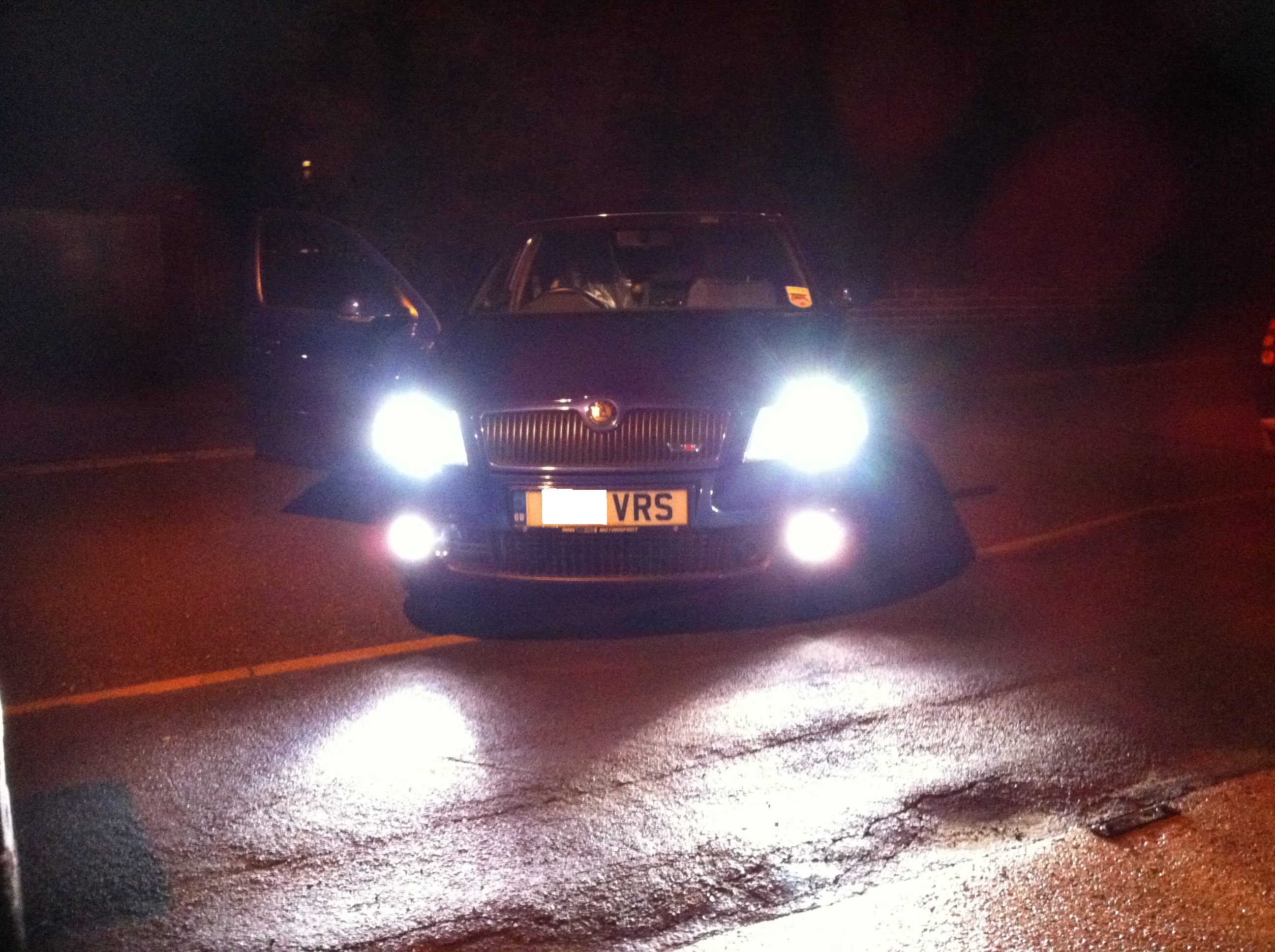

This is mine with HID kit fitted using 50 watt kit and 6000 k bulbs, lower fog light bulbs are, PHILIPS diamond vision 5000k white headlight bulb H1. side light bulbs are canbus friendly 3 led 501 capless bulbs. ive turned the cold start off on the headlamp system and side light system using vagcom and been running these for about 9 months and never had a issue.
