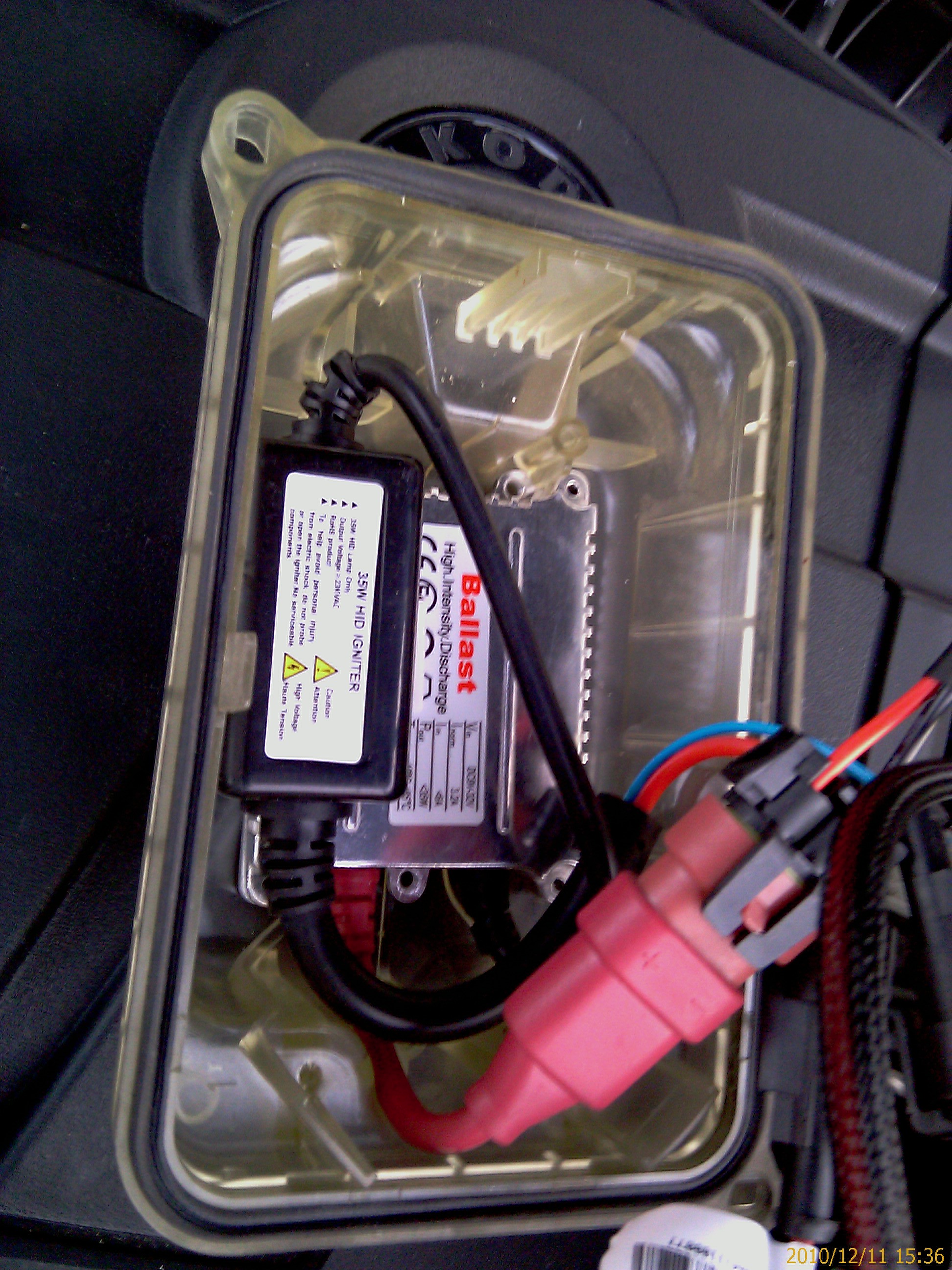

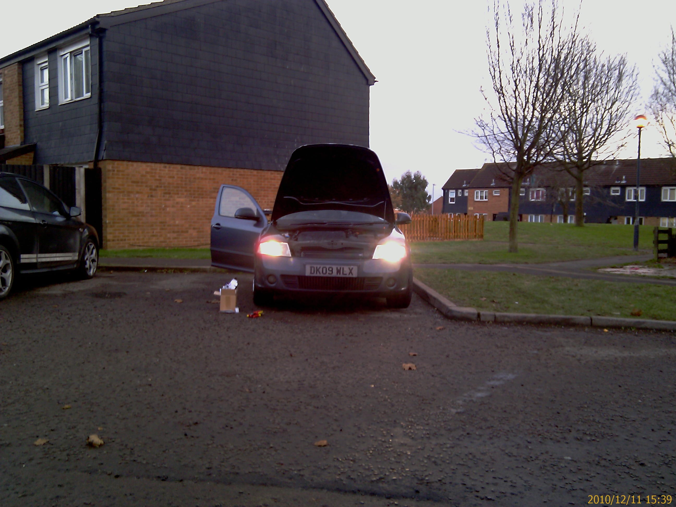

Fitted mine this afternoon, now I need somebody local or at least not a million miles away to connect VCDS tomorrow if anybody will offer :D.
I stuck the Ballasts to the inside of the dust cover with No Nails removable sticky pads
They work when the engine is not running but flash when it is
Right one is HID.
Right one is HID.
Darren
Any chance of compressing the pic's slightly, they are HUGE!!! Also, are you saying that after fitting the HIDs they work with the engine off, but when you turn the engine on they flash? Or are you refering to the bulb warning light flashes? I would be grateful if you post the results when you get the coding changed. :thumbup:
Edited by Pagey1255
The Lights flash for a bit then turn off, I hope this is not a power drain problem. the dash light is just permanently on but only when the cars engine is running and the lights are switched on.
