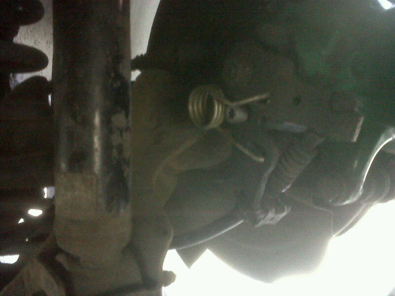

I have the problem where I apply the handbrake, release it, and only one calliper actuator returns to it's stop (nearside).
The other actuator floats with about about a 5mm gap (offside). I can push it back to the stop, but can't keep doing this forever!
I have removed the actuator, cleaned it up, cleaned the splines, the cable fixing bracket, and the back of the calliper, to make sure it isn't sticking, but this hasn't improved it.
I noticed that when I apply the handbrake very hard, that the offside actuator can reach the 'fully on' stop on the calliper bracket, where the actuator on the nearside wheel only moves to about half way.
I have spotted in another thread that there are some springs (a VW part) which can be bolted onto the back of the calliper, to help with handbrake return.. Might these be what I need, or does the problem sound more fundamental?
Cheers all!
For anyone else experiencing this problem, here are my findings............
Springs obtained from local Seat garage last night for a total price of £4.15
Fitted them and used the handbrake adjustment procedure above, and it has sorted my problems out.
Pic of the offside spring fitted - very strong spring, and a right PITA to fit!
Cheers, Andrew.

bump for spring part number please !!!
Here are the part no's for Fabia ones:
http://www.briskoda....ost__p__1758478
Look the same but he's got his fitted the reverse of what they are on the Octavia in the pic earlier in this thread.
