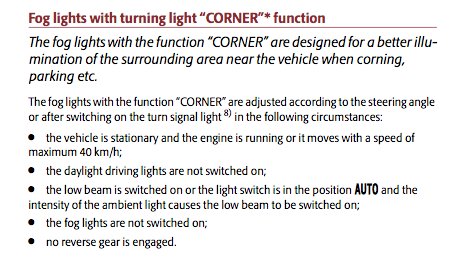

Your vehicle has corner fogs which will operate below 24mph with lights on.
In reverse both fogs should come on
turning or indicating will turn on the fog on the side of indication or turn (up to 24mph).
The owners manual never metion these little things ... thankyou TP :thumbup:

Hi gp001,
the corner fog function is standard on the Elegance but sadly an option on the SE. Had them though on my previous SE and they work well.

I understand you can turn the cornering Fog lights off in the maxidot.

If my browse of the manual and the maxidot, followed by my drive home this evening is anything to go by, you can only turn off the cornering fog lights by turning off the cornering headlights as well, which I don't want to do.

I've just looked at the manual. If the light switch is on dipped lights and NOT on auto, I don't think the fog corner lights come on -

Update: I just had a call from John in Skoda Customer Service. He confirmed that the cornering front fogs have been approved for use in the UK - which is as I would have expected. He explained that this is because they only come on one light at a time, depending on which way you are turning/indicating. I did mention that I thought I had noticed both fog lights being on at one point. His suggestion was that I should take it to a Skoda retailer to get it checked because it isn't meant to do that. I think I shall see if I can catch it happening again before I do that. It's not easy, though, finding a suitably shiny vehicle to follow - especially in this weather!

Just remember that the top third of your foglights are in fact Day Time Running lights. Those are always on from the moment you start the car (if so set in the Maxidot). The bottom two thirds of the round lights are the real fogs and these should only come on one at a time depending on your steering angle and indicator positions. They will only ever both come on when you select reverse or of course if you switch the fogs on! emoticon-0140-rofl.gif
I'm pretty sure the lights I saw were the fogs, not the daytime running lights. If I do have an opportunity to check it out again then I'll make sure I have the DRLs turned off, to avoid any possibility of confusion.
