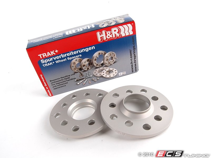

I can see why you would think that-I thought the same at the time. The problem is the back of the Zenith wheel is chamfered slightly at the hub, meaning they just don't rest on it. As stated at the start of this thread, I started with 9mm universal ones!
In that case I don't see how the small extension on the hubcentric spacers will make any difference!
Well I only started this thread because I was having problems with non-hubcentric spacers..... :wonder:

Only ever run 15mm dainott - they do markedly improve the look though if you're going to leave it at standard ride height. 10mm should make a reasonable difference too though, but at standard right height I'd go 10mm at the front ant 15mm at the rear for best results.
Now something I've learned today - H&R make 8mm hubcentric spacers WITH a lip. H&R part number 162555719. Happy days indeed.
Oooo do they that sounds about right with the 30mm drop I have as the car has to be useable.
Look how thin the lip is on the 8mms :D
If they're TUV approved they should be OK? :thumbup:
I'm ordering some tomorrow. I've noticed on some pics of second hand 8mm ones the lips are damaged.
On the wish list. :thumbup:
I have ordered a couple of sets of the aforementioned H&R 8mm hubcentric spacers WITH a lip. The 162555719 ones with a 150mm diameter. £125 inc VAT and delievery for two pairs - special order from H&R in Germany. Took a bit of getting hold of actually. If I don't end up using the second set I'll sell them unused at cost (£62.50). PM me if you might be interested.
