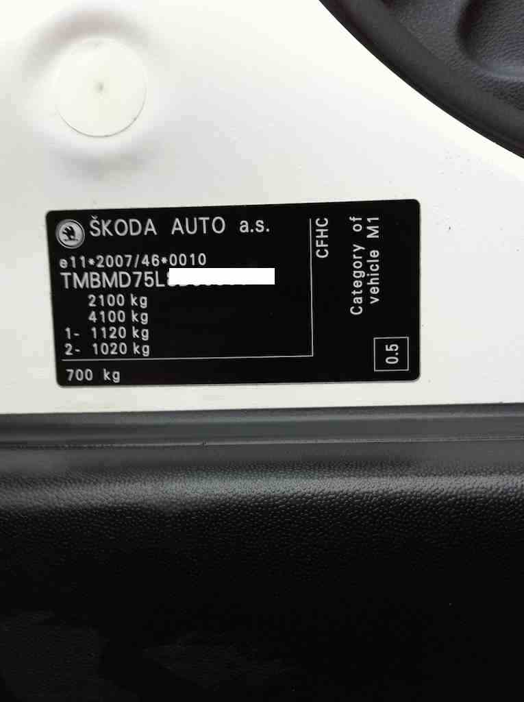

Hi Mike,
regard the engine code either on the build sticker (service book & boot floor) or the data panel on the drivers door pillar. Believe though this CLCB engine has only been mounted to manual gearbox models.
In the example above top right CBDB is the engine code (TDI CR 140; production start to November 09).

Here is mine, built week 46, november 2010
Mike
Mike
Hi Mike,
thanks you have the CFHC engine which replaced the CBDB version from WK45/09 and can be mounted to either manual or DSG gearboxes :thumbup:
