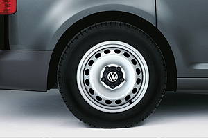

Try mytyres.co.uk they do Skoda model specific steel wheels fitted and balanced with winter tyres from £92 per corner plus delivery
Check out this link :-
http://ssl.delti.com..._p=Steel_wheels
Just one note on these MyTyres wheels: they might be Å koda specific but they are of a different shape. So you can't fit standard VW Caddy centre caps (they are too big since the "dish" part of their steel wheel is smaller). Not sure how well the Å koda full wheelcovers fit to these either. So only option to use is the VW Caddy centre caps with the five visible bolts since they are smaller.
  • 4 weeks later...
Again just to close the loop for future searches!
After member ejstubbs posted here that his T5 centre caps did not fit I did a bit of research and found that a VW T5 in fact uses a 5x120 stud arrangement vs the VW Caddy and Yeti that uses a 5x112 arrangement. So I have to admit I led people up the garden path here! Although my first caps (the ones with the written words VOLKSWAGEN and no VW logo on the photos of this thread) were advertised as from a T5 they were in fact from a Caddy! Hence my own confusion.
So to anyone out there trying to source centre caps do NOT buy T5 cente caps. You have to find the far scarcer Caddy ones.
