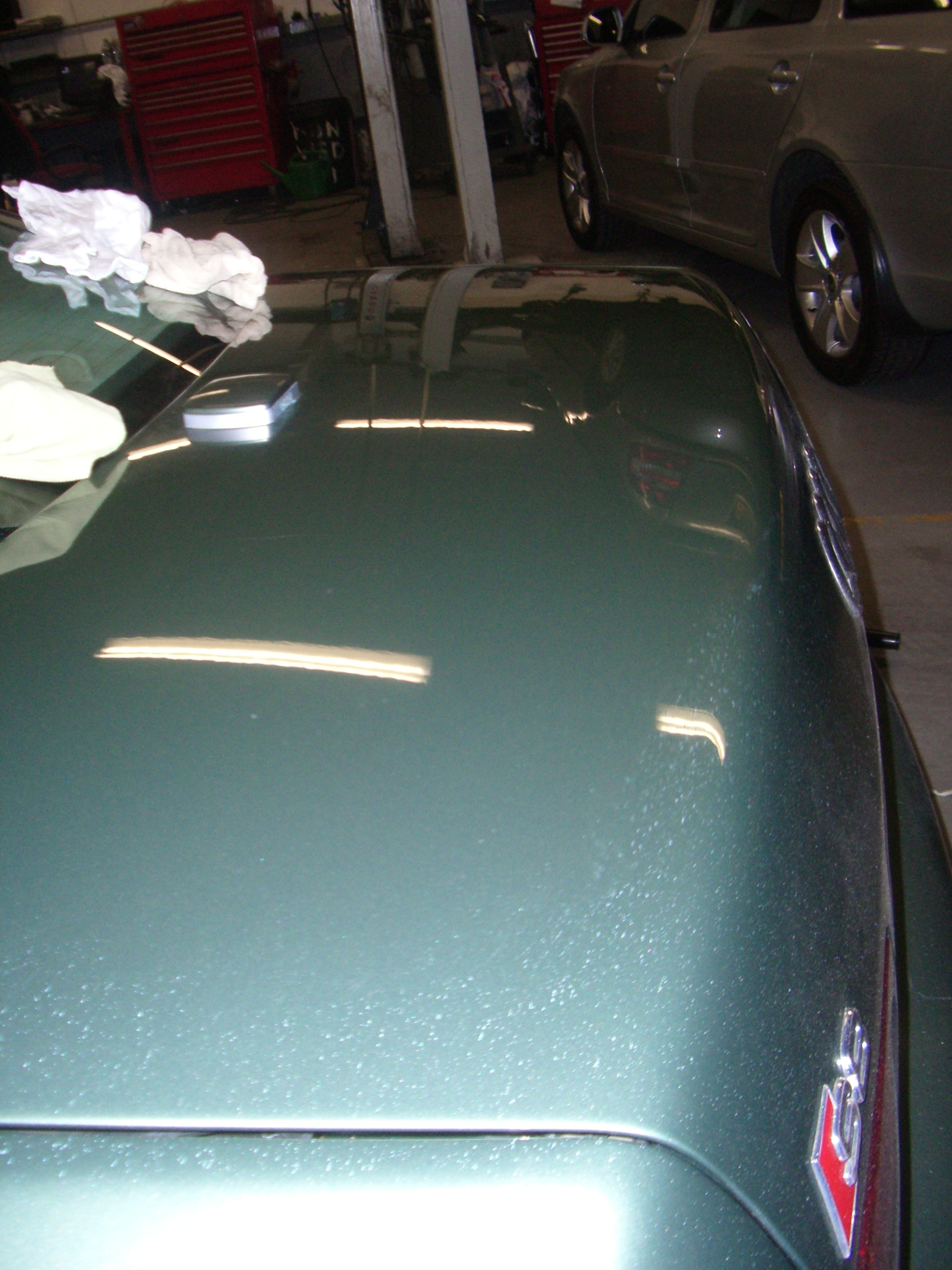

I tried using a higher speed and it did seem to make a difference. Have a nice shiny finish but still some marks there, I have attached some photos but they don't really show up.

Presta polishes are very good but if you have the Swril Remover product then I think you will find this is more of a filler than providing any cuttng action so you will struggle to remove swirls. This will also be the case if your using a polishing / finishing pad which I believe you may be suggesting if the pad is very soft.................... :|
I see that your trying to correct and Audi S8 and speaking from experience the paintwork on these are a lot tougher than your average VAG motor so this will be why your struggling, to really make and impact you need a rotary, cutting polishes and pads with a follow up of some finishing polished and pads............... :thumbup:
