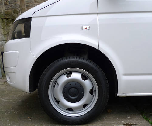

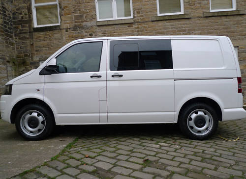

The Volkswagen T5 van in 180hp guise does come with 17" steel wheels. They do come up on eBay from time to time but are very, very scarce. They look like this:
BUT you will pay for winter rubber. A LOT more. So as others have said I'd suggest the 16" route as well.
Have you got a part number for those?
Alas no (I copied those pics ages ago from a seller on eBay). But any VW Van Centre will give it to you. I've phoned them before asking about 16" silver steel wheel prices and part numbers. And as I said they only do this one 17" steel wheel AFAIK - so should be easy enough for them to find for you.
Ok, so I've been looking at steels on ebay to be my winter wheels assuming that this is a good time to buy ie i'm going to be the only one thinking about winters in june!
I've found a couple of set of these 17" van wheels but it appears that the T5 is 5x120 not 5x112. Updating the thread to avoid anyone else wasting time..
