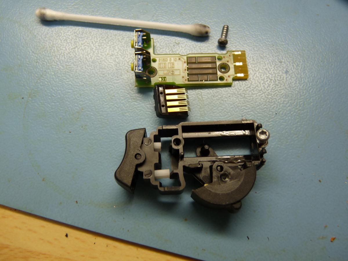

If you don't have contact cleaner, vodka on a cotton bud does the job brilliantly. Had this twice in 6 years. Takes 5 mins to do with a hex and a stong finger nail. No filing required... :-)

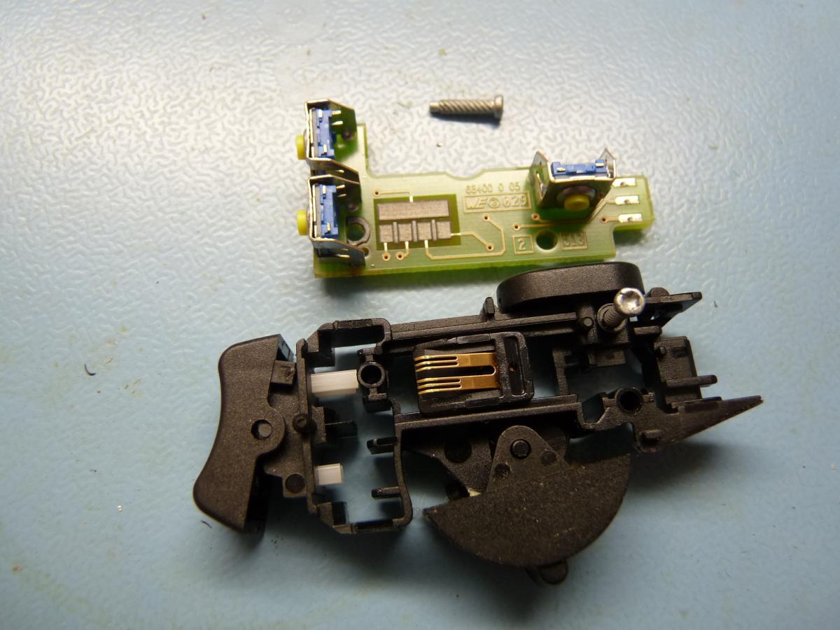

I have had intermittent failures of the Cruise Control switches and also un-called-for windscreen wipes. The CC would sometimes not lock on and, worse, sometimes asking for lock-on produced hard acceleration - presumable doing a "resume" to a faster setting. The sprung "OFF" switch often failed to work but the brake switch disconnected the CC. Thanks to the above posts I have removed and cleaned the sliding contacts with alcohol.  I used a half inch wood chisel to prise off the switch cover without damaging the plastic. Both switch covers are opened in the same way but it is not necessary to remove them completely - better to leave the far end in place and gently bend the cover. Pictures show the CC switch cover open (LHD car), CC switch disassembled and computer/intermittent wipe switch disassembled. I don't know the resultspost-87987-0-58580400-1479035590_thumb.jpgpost-87987-0-48831400-1479035572_thumb.jpgpost-87987-0-43227400-1479035608_thumb.jpg yet and I am hoping that the sealed push-button switches are not faulty.
