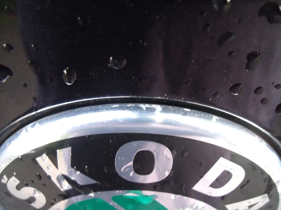

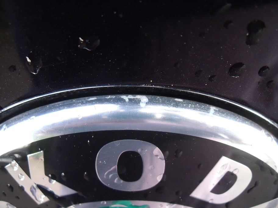

Hi James just taken a picture of my tail gate badge with a little white worm in it. not to worried about it on this one as it will be going when my new one finally gets built

Just checked mine. The worm is there !
reckon the worm on mine was very hungry.
it's like this all the way round
