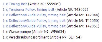

gates kit is good I fitted it to my car
make sure you get the hydraulic tensioner as well as the belt and pulleys + do the waterpump and thermostat at the same time
Yeah thanks, it includes all those parts.

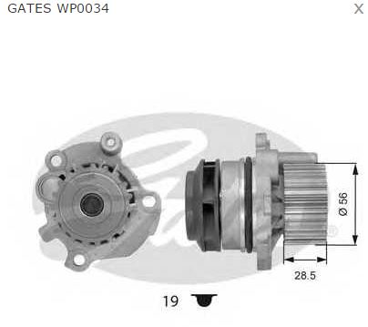

Not clear from your post but make sure the 'wasserpumpe' is of the metal, rather than plastic type for piece of mind :thumbup:
Thanks Giradi. It's this item. Does it look right?
Looks right to me
