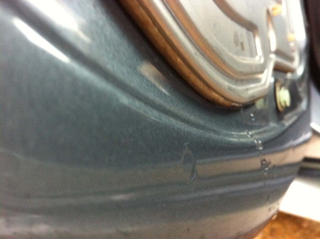

Then I flooded the joint between door and bodywork from mid point on the top of the door to the base of the front of the door - result: standing water in the footwell! Examination showed that the cable wrap on the bunch of cables underneath the bottom edge of the bonnet pull trim panel was saturated - so clearly water is somehow getting into the car through the forward edge of the door aperture.
However the face of the door seal was dry all around the door opening suggesting it's getting in between seal and bodywork, or somewhere else, not between seal and door - or in other words the seal is operating properly against the closed door face.
Here's the area of ingress - you can see the black wrap around the cables which is saturated:
Detail:
The problem I've now got is that I cannot make the bonnet pull trim panel budge at all excepting bending the base; neither can I see any way of getting the bonnet pull lever off which looks necessary to remove the panel once it's loosened.
Without getting that panel off I can't release the door seal all the way round since it clips over the edge of it without sufficient play to disengage.
I can release the door seal down to the bottom of the fuse aperture and feeling in there once done suggests the leak is lower down than the fuse panel area. I can unclip the door seal along the base of the door up to this panel but that's dry too. So the ingress area must be in the area of that panel.
Help! How do I get that panel off please?

Right - another failed attempt this afternoon to sort out the leaks. At leak I managed to get the bonnet lever off - here's how:
View of handle from the direction you view it in the car:
View of handle from the other direction:
See the slot - put a stubby screwdriver in there and prise out:
Two more views, out and in - and the stub of the mechanism:
Having done that I STILL couldn't get the trim panel to budge - there seem to be two fixing points towards the front edge - but I can't see how to release them - does anyone have a picture of the back of the panel out please?
However looking through the hole revealed - though it's difficult to see in the photo - I could see droplets of water on the blue paint behind
... and taking the fuse cover off revealed condensation on the back of it and a damp feeling inner bodywork at that point.
Assuming it's the door seal that water's getting around I've tried pushing it on as tightly as it will go to see if that cures it.
Whatever it is the floor's pretty damp again this afternoon despite it being dry for the last few days - so clearly water has got in somewhere since last weekend.
If it's not the seals I'm presently stumped!
