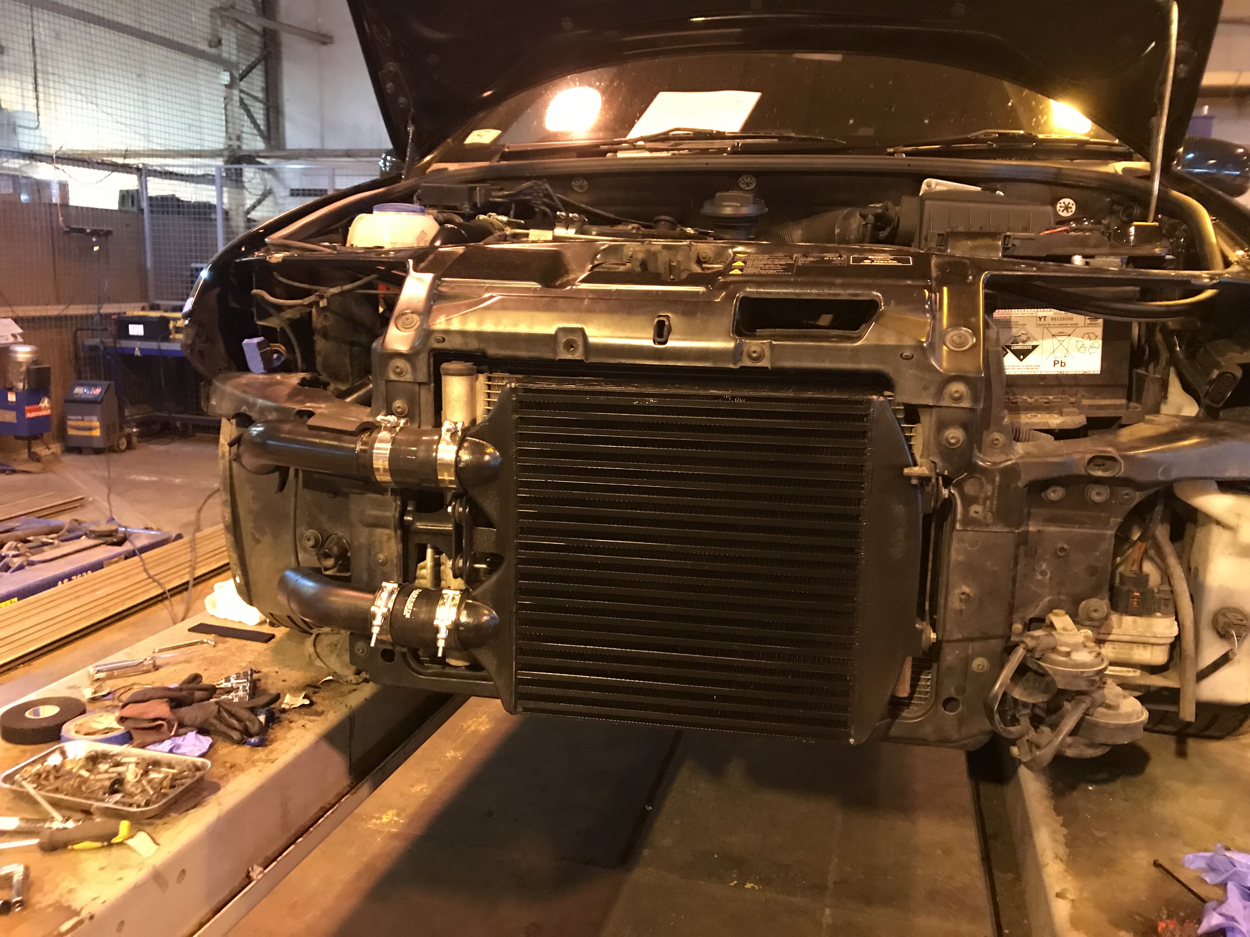

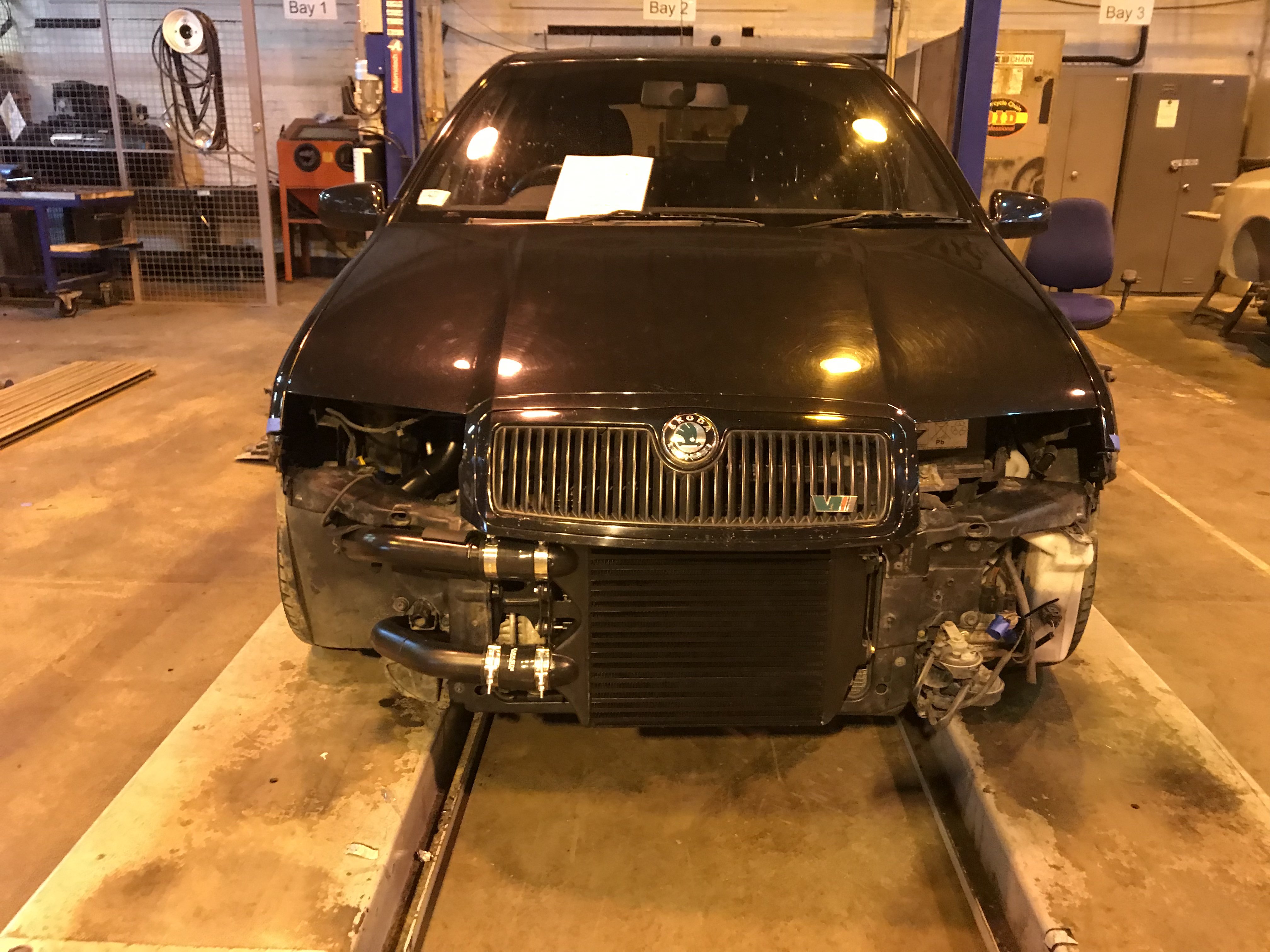

I’m currently fittings full darkside kit including egr delete. There is a lot of fettling to be done so I’d highly recommend a grinder/ air saw- a dremel will take you around 500 years to complete the install. It’s a quality piece of kit though and also includes a proper turbo connector.
has anyone that already has a fmic and egr delete experienced a supercharger type noise under hard acceleration? I’ve double checked for boost leaks and everything seems spot on and the car pulls well.
