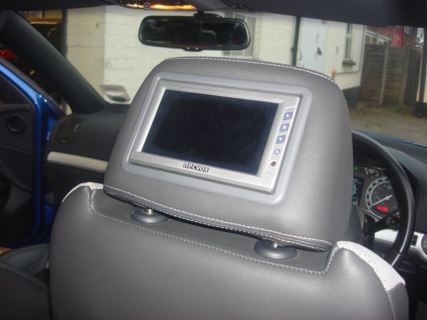

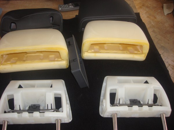

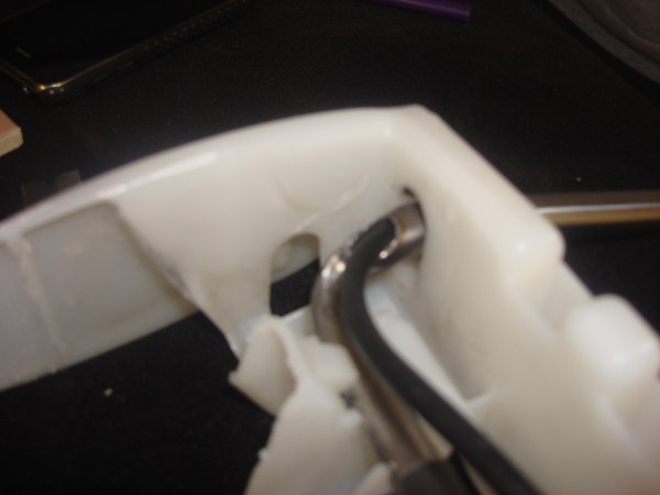

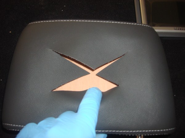

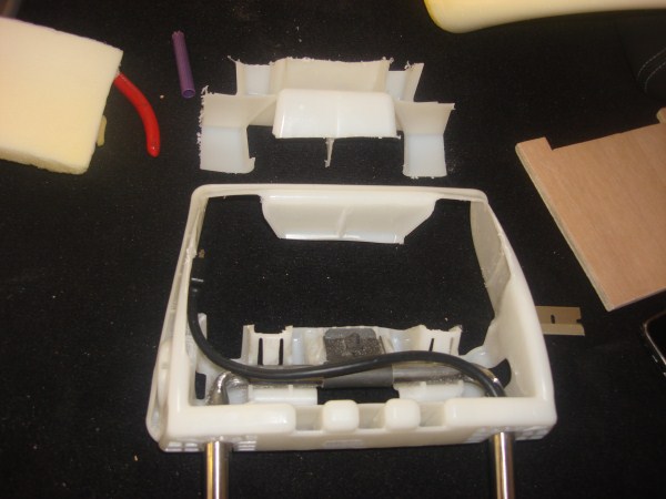

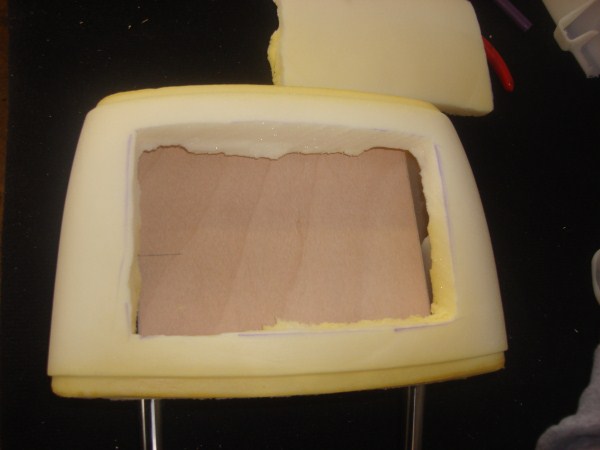

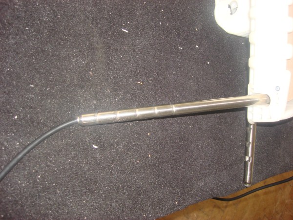

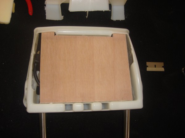

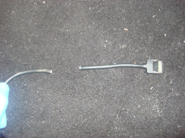

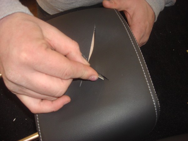

Well i attacked my car and got around to fitting my rear screens. Shooting myself now for not going for the slim line Veba's but the Necvox's were just too cheap to miss out on. It was a little fiddly as first, the screen boxes are so deep on the Necvox's so a bit of jiggery pokery and packing out was needed but they look fine now, secondly, they older style screens don't have the 12/14mm post cable plugs and i wasn't going to cable tie them up or anything silly so out came the cutters and i re soldered at the bottom of the seat. Any how they are all working fine with the dual zone option on my HU and my children are very happy so i do believe it's mission accomplished B):D

The screen looks to be angled up quite a bit (shape of the headrest) is that right or just the way you took the photo?

It was just the way I took the photo, I had to tilt the headrest forward to stop the glare of the flash. Needing to source a few extra bits and bobs now to finish my project. The little ones are very happy though and oh so quiet!!
