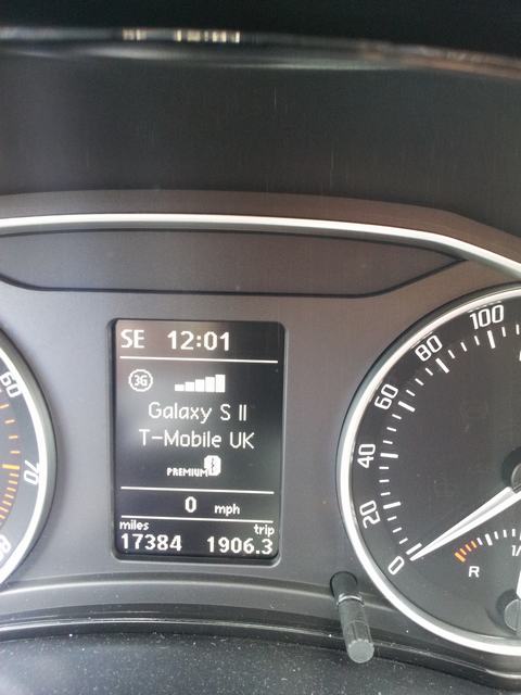

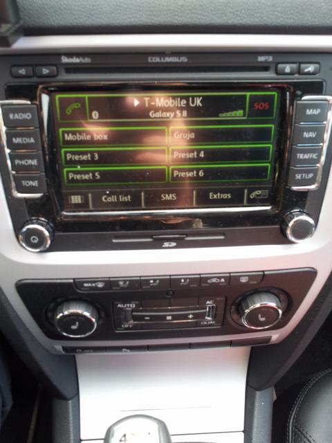

Here is a pic of the Bolero
3A786835F1E54262831112992820FFFB-0000326183-0002317940-00480L-50E1E69DEBD3427EAFB244B0CA6265BE.jpg
One of the Maxidot
Top line is Signal Bar
Then Service provider
under here then normally i have 3 icons
from the left:
Battery
Bluetooth
and i assume phone ?? << Not sure
But if you look you will see another icon between icon 1&2.
This I have no idea as to what it is as it only started appearing today AFTER I choose to update my phone bookemoticon-0108-speechless.gif
E0FD9BE63C6B4CD8873941C78D43BD10-0000326183-0002317939-00480L-B84F558AFA28402D9BD4E95373F177EE.jpg
Then at times i can access this reading
F9498051B6244AC294B2D8533B1C6C37-0000326183-0002317938-00480L-80A4D3B9E5764C4986018EDAB67BAF4A.jpg
